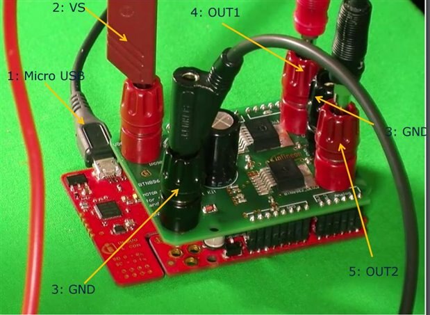

Trying to find connectors for the motor shield:
INFINEON  DCMOTORCONTRBTN8982TOBO1DCMOTORCONTRBTN8982TOBO1 DC Motor Control Shield
The large holes I do not want to solder them. What are they called and where to buy?
    dougw over 9 years ago +3 suggested
    Those holes can work with binding post connectors. They look like this: Farnell sells lots of them: here are some examples: 111-0702-001 JOHNSON, Binding Post, 15 A, Nickel Plated Contacts, Brass, Red…
    0 dougw over 9 years ago
    111-0702-001 JOHNSON, Binding Post, 15 A, Nickel Plated Contacts, Brass, Red, Newark element14 Canada
    BP30B SUPERIOR ELECTRIC, Binding Post, 5-WAY Series, 30 A, 1 kV, Gold Plated Contacts, Brass, Black, Newark element14 Ca…

    0 johncshafer over 9 years ago in reply to dougw
    Thank you!
