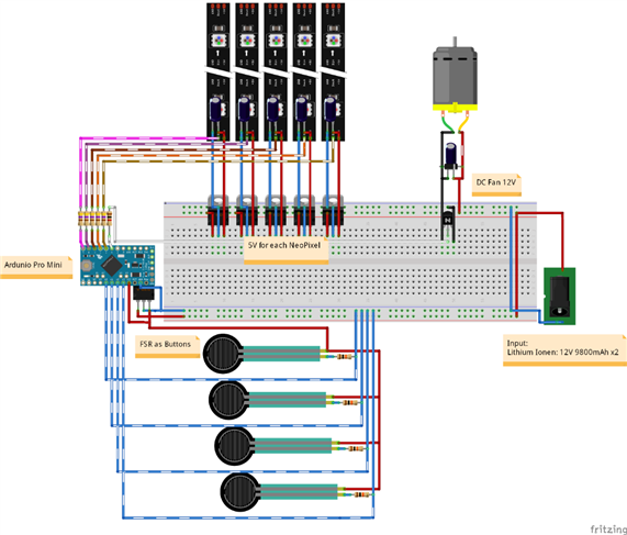

I'm building a costume for a friend and he wants LEDs and a Fan, this shouldn't be hard but I thought wrong.
(I don't know if this is even possible with an Arduino....)
So here is my idea.
I have an Arduino that controls 5 NeoPixel LED strips and a fan, the LEDs should change colour or in the case of the fan the speed when he presses on of the 4 Buttons, in this case, FSRs (Force Sensitive Resistors).
The first 3 controls the Colour with an effect of some sort.
The last one has 2 modes to manage
1. when he holds the Button down the Fan should speed up, when he presses it and holds it down again in a very short amount of time the fan should slow down to a specific speed.
2. When he just press the button all LEDs should go off or on again.
I have done the first idea in Fritzing and I don't know if this is good or the worst thing you guys have ever seen.
I hope you guys can help me.

    I would start by building the circuit in stages. Start with a single neo-pixel and add some code to just flat some colour etc. Then add the rest of the pixels and check functionality. Then the motor. Keep…
    mcb1 over 9 years ago +2 suggested
    The neopixels come with some very good examples in the Adafruit library. You should be able to drive all 5 from a single regulator. https://learn.adafruit.com/adafruit-neopixel-uberguide/power gadget.iom…
    mcb1 over 9 years ago in reply to niteowl12 +1 suggested
    niteowl12 Good spotting. The Sensing pin A0-A3 need to connect between the FSR and the pulldown resistor. Also PWM is only available on some pins. https://www.arduino.cc/en/Main/ArduinoBoardProMini You…

    Thanks for all the replies so far,
    I changed now something like the wrong placement of the sense wire for the buttons and the control wire for the PWM.

  • niteowl12
    0 niteowl12 over 9 years ago in reply to soxx
    Please make sure you account for power dissipation. You are looking at (12v - 5v) * 3.6A = 25.2W of power(ballpark) that needs to be dissipated by that regulator. my first experience figuring this out made a board get hot enough to boil water. I would suggest finding a way to use the 12v to power the neopixels by putting them in series if you can or finding a simple DC/DC buck regulator from sparkfun or adafruit. one that's already put together to make it easy for you.

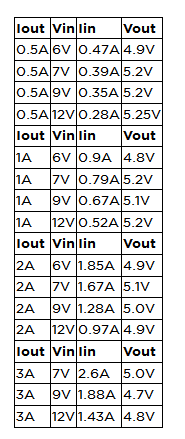

    0 mcb1 over 9 years ago in reply to soxx
    I want a pretty long runtime for the circuit
    The first comment I'd make is the neopixels don't need to be run at 60mA (all three on).
    They are BRIGHT so unless it is in sunlight you may find you can get away with 30mA or less when it's running.
    If you're only using one colour it will be a third of whatever the figure is.
    The DC/DC converter is the best option to eliminate the heat component and save on energy wasted.
    You also gain a bit more run time using these.
    So using 85% efficiency 1.8A out is approx 0.92A in at 12v
    0.92A = 920mA x 5 strips = 4600mA (ignore the fan)
    19600 / 4600 = 4.2 hours at FULL BRIGHTNESS
    One thing to be aware of, most of the rated mA on these battery packs aren't.
    However I think considering it won't always be on white, you should get  4 hours easily.
