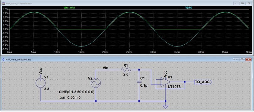

    Initially i was thinking of using this circuit to do this latter figured out that the opamps cannot keep up with the variable voltage and frequency up 9Mhz.

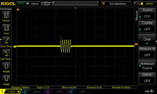

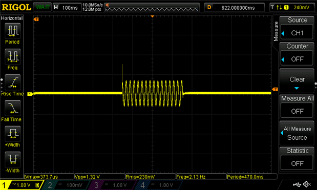

    Now rewound the MOT and took a reading 40cm apart.
    At 110ms
    at 310ms

    Now your traces look like the real thing !
    You will need to be able to measure the amplitude to the required degree of accuracy within each mains cycle. Arduinos are not brilliant at controlling the rate at which the ADC samples but they can be made to sample fast enough, you want at least 50 samples per mains cycle = 50 * 50 = 2500 samples per second (for 50Hz mains.).

    based on your suggestion i've put up the schematic and simulated it. Looks good to me but am looking something cheaper 7$ for the LT1078.
    here R1 and C1 make up the Low Pass filter. The opamp acts like a follower and a half-wave rectifier.
    Half_Wave_LVRectifier.asc.zip

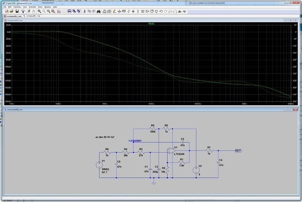

    Your design won't work very well (using an op amp as a rectifier isn't too nice). This is a bit more complicated but will do the job. The amplifier output is biased at about 2.5V. The bias comes from the 5V supply via R6 and R5 so the supply must not be too noisy although C3 does filter it.
    Almost any amp would do for U1, the LTC6240 is just the first that came to hand for simulating - I suggest the Microchip 6281 which comes in PDIP, SOIC or MSOP packages and costs about £0.50.
    This design relies on having a very low DC source impedance so should be OK for this application. There ought to be some decoupling across the supply close to the op amp in real life (100nF ceramic)

    It's not that complicated image
    One op-amp. and some Rs and Cs.
    I was quite pleased with myself in getting the filter and level shifter in one op amp. It  would be better with more attenuation at half the sampling frequency (1.25kHz) but should be OK .

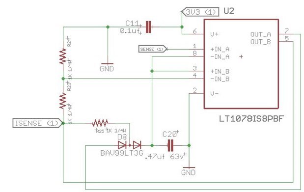

    I've attached the schematic of the PCB that i now had fabricated for testing.Will have to add these and one suggested by dougw as well in my next design. but before that i need to see how this goes. This was something i had used for reference for the current sensing part. my first one did not very well. Components are SMD and without SMD reflow oven and just with a cooking hot plate temp fluctuated and some components were damaged.

    I just simulated your design and i can see for any rise in the ac signal has significant rise in the output voltage. Should be easily detectable by an arduino.
    but a few doubts, what does R3 to R8 and C1 to C4 do in your design ? i am just learning to put Opamps into use. Took me a while to make sense out of what inverting and non-inverting terms actually meant.image
