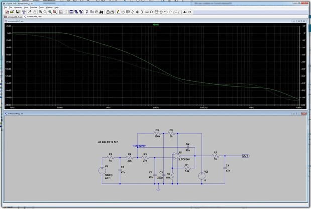

I have ac Signal fed into an arduino ADC. Some say sampling is better than smoothing the signal. Why is that ? Circuit is as shown below.
    0 dougw over 8 years ago
    If you want to know the amplitude of the AC, you should rectify it before filtering.
    if you just filter AC you get the average value, which is always zero.

    0 anishkgt over 8 years ago in reply to dougw
    Thank where about would i need to do it ? would it be able to follow the ac peak voltage or at least show some variation when the ac is varied by 0.1 ?
    0 dougw over 8 years ago in reply to anishkgt
    Put a diode in series with the AC signal before any filtering.
    If you need to see small voltages, reference the other side of the AC signal to a .7 V voltage divider. (to overcome the diode voltage deadband) This makes the signal start at .7 V but there is no deadband.
