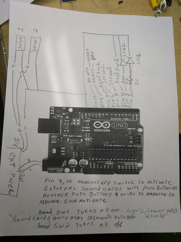

I am trying to write code for an automatic railroad crossing gates for my grandsons train table i built. I have no clue what i am doing. What i can say is im using 2 servos with external power 4 red leds that need to flash and a speaker for bell ding which i was hoping to use a sound file to play back my wire config is 2,3 for leds  2 servos 5,6 I also have a 10 second record-able device for train horn which uses push button for playback. i wanted to cut off the push button and use the arduino r3 to act as the push button pin 8. Also i will have 2 reed switches one to activate gates and lights and one to deactivate pins 4,7 this is what i have so far I get the lights to flash but im lost from there can some one help me write this code?

    Enrico,
         Not sure if you had a chance to look at the new code and schematic I posted. I think it would be easier to modify because it is closest to what i am looking for. it only needs the switches added. Unfortunately Ive been trying to figure it out myself but just not getting it. Everyone has advice but I don't think they understand I know nothing about writing code. I wish i had more time to learn, going forward I will be doing more tutorials Because I really like the possibilities of the Arduino system and am interested in learning but for now im in a jam. I appreciate any and all help you can give me. Again I would like to thank you for your time, as I'm sure you have better things to do.

    Enrico,
         Ok I really appreciate you helping me. I wasn't for sure if you had seen the new stuff i posted. it is 6:30pm here im usually up all nite as I am retired. I will post some pics of the table and a video once I get it operating correctly. I am currently running all my wire for lights ect.. servos and crossing lights are already ran just need to hook to Arduino.Again I thank you very much and look forward to hearing from you.

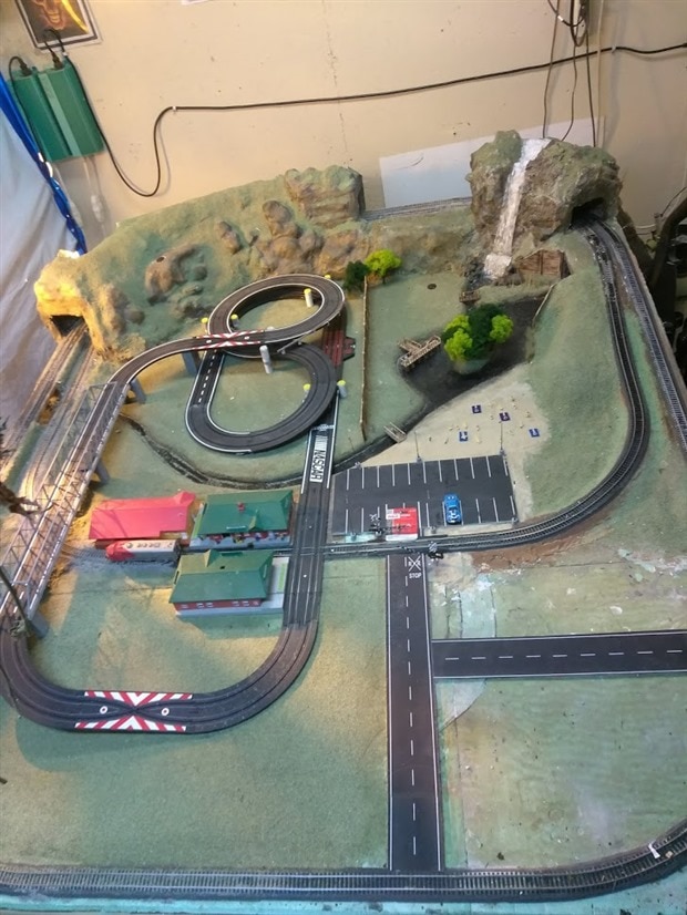

    0 14rhb over 8 years ago in reply to theshay
    Edward,
    That is a great setup you have there.
    Rod

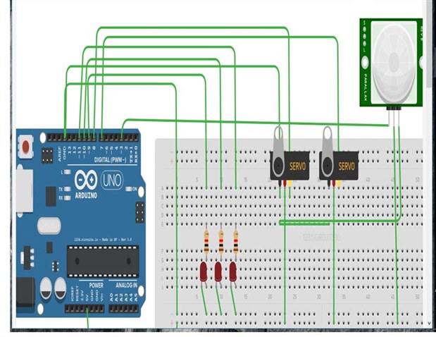

    Hello Edward.
    Now button (that replace the reed sensor but the code remains unchanged) and the servos (I have only one here but it should work with two as well) moves accordingly.
    This is the code:

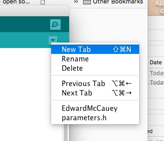

    how do I add H parameter to library?

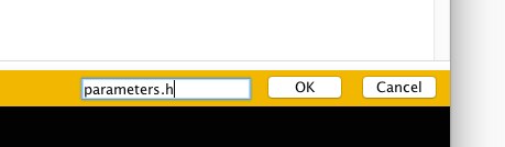

    0 balearicdynamics over 8 years ago in reply to theshay
    No need library. With the IDE open, on the top-right side, you find "add new tab"
    Then write down "parameters.h" and paste the second block of code in the empty file. Take a look at the images below.
    1.
    2.
    3.
    Enrico
