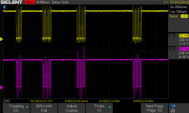

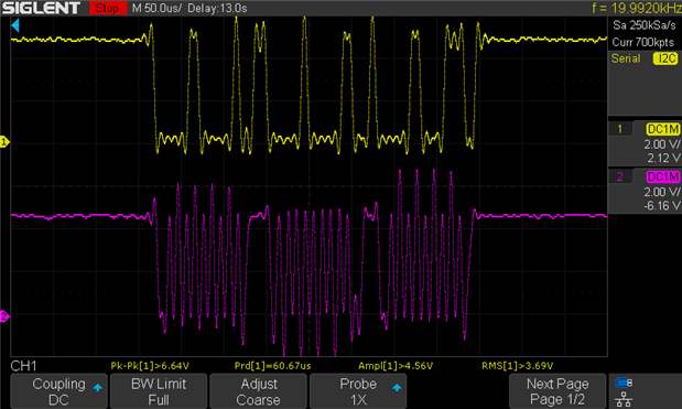

I am working with IIC in order to hopefully fix a project. I've uploaded the IIC master and slave examples and they both worked flawelessly.
Now when running my own code, everything turns into rubbish.
I am using an Atmega 328P on a breadboard however, that's the only difference between the master and slave examples.

The code for the master is
void setup() {
  Wire.begin();
  Serial.begin(115200);
  Serial.println("Requesting status code");
  // Ask for the status code
  Wire.beginTransmission(IIC_ADDR);
  Wire.write(0x10);
  Wire.endTransmission();
  Wire.requestFrom(IIC_ADDR, 1);
  Serial.print("Status code: ");
  Serial.println(Wire.read());
Edit:
I think it might have something to do with not compiling for the Atmega 328 with internal 8Mhz clock
