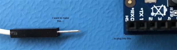

What’s the generic term for the single pin crimp terminal to stick on the end of a wire in order to push into an Arduino header socket?  I’m used to the term Dupont connector but this isn’t a search term recognised by Farnell or CPC and there seems to be a fair mix of crimp terminals that may or may not be correct.

    Hi Andrew, I think it's just called a crimp socket, or a 0.1" SIL socket crimp terminal. Anyway, a typical one is this crimp socket crimp socket , it fits the 0.1" SIL pin headers on the Arduino. There…
    0 shabaz over 7 years ago
    Hi Andrew,
    I think it's just called a crimp socket, or a 0.1" SIL socket crimp terminal. Anyway, a typical one is this crimp socketcrimp socket, it fits the 0.1" SIL pin headers on the Arduino.
    There is a suitable crimp toolcrimp tool for it too.
    There are plastic pieces to go over it, but I don't think they are available from Farnell/Newark for single pins. However, personally I feel heatshrink sleeving gives a nicer result.

    Thanks guys, but I probably didn’t explain it very well.  I have the crimp tool that you told me about previously Shabaz, but the crimp sockets you mentioned, above and previously, didn’t seem right: they look like sockets (obviously! And something I would push a pin into) but didn’t have single housing in that series, and I couldn't find what I was looking for in that series either.  Heat shrink is a good idea for the housing and I have plenty of that.
    Doug - the links you provide don't work for my Country (UK) but I suspect from the wording they are sockets as well.
    What I'm looking for is the pin connector, I.e. the crimp terminal that is a male pin to push into a female header socket.  There seems to be a lot of variations but I can't really make out which would be the right one - I think a 1mm pin should do it - but it doesn't help that I don't know what they are called!  The dupont fly leads seem to fit properly but the ones I have aren't long enough.  I could buy a Dupont crimp kit on Amazon but they all seem to be from cheap Chinese manufacturers and I'm very wary - as Frank mentions.  D-sub pin terminals look ok but I realise they are intended for a different connecter.

    0 shabaz over 7 years ago in reply to Andrew J
    Hi Andrew,
    Oh, sorry, I forgot the Arduino has the sockets and not pins.
    These crimp pinscrimp pins will fit, and are cheap, although stock is low currently. I've used these with heatshrink, I don't think these particular pins will fit the plastic housings Doug mentions.
    The pin is of the order of 0.7x7mm. 1mm won't fit (e.g. typical D-sub pins won't fit, they are approx 1mm diameter).
    EDIT: these crimp pinscrimp pins will also fit (0.635x0.635mm) and better availability, but they're more expensive.

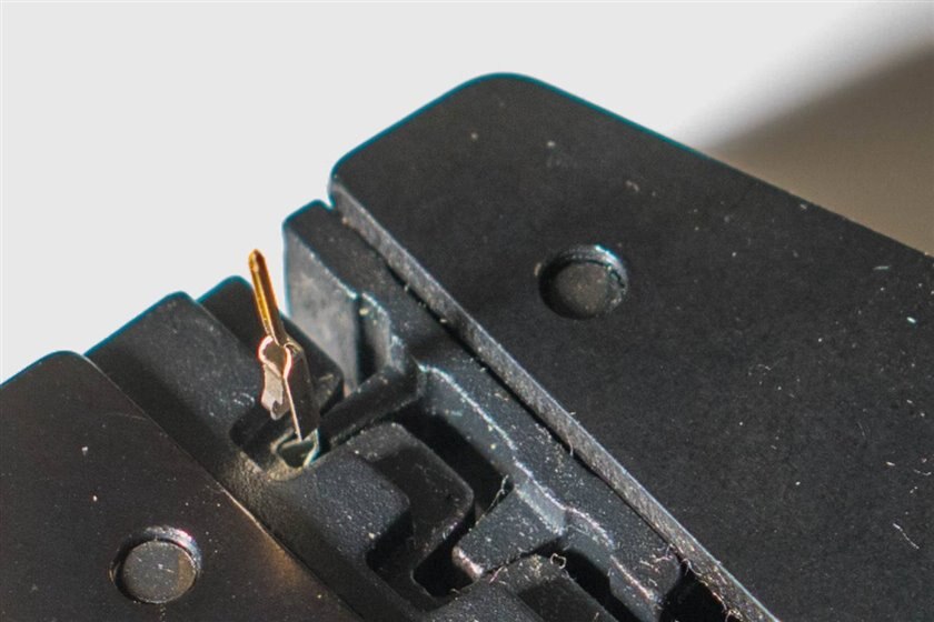

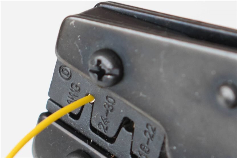

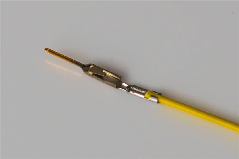

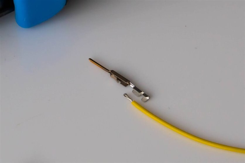

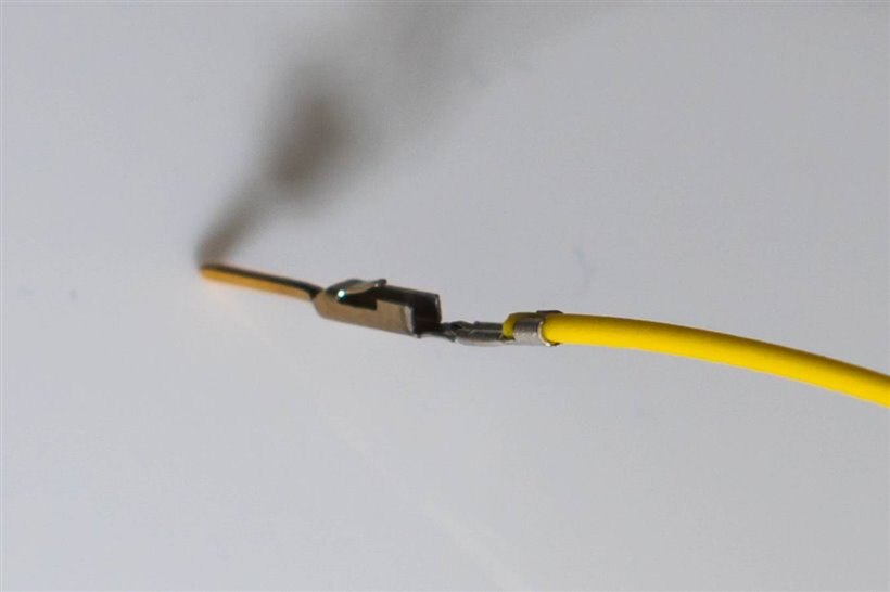

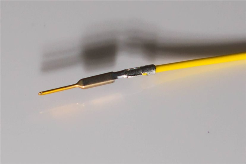

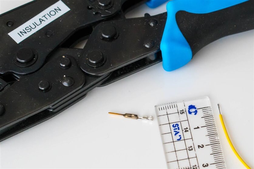

    I had the camera out, so figured I'd take some photos.. I don't have the China crimps (although I did try them at one point) so cannot show the difference.
    Step 1: strip cable, by about 4mm (eyeballed, no real need to measure with the pin crimp, since there is space for the excess length. The socket crimps need a bit more accuracy but can still be eyeballed). I'm using thin wire (10/0.1, i.e. 10 strands of 0.1mm) so I like to fold it back, so I strip twice this amount.
    Step 2:
    Since I'm using thin wire, I fold it back. Ignore this step if you get good results without doing this with your wire type.
    I just use a fingernail to fold it over, no need for pliers.
    Step 3: Insert crimp so that the to-be-crimped portion of the crimp pin is flush with the tool crimping area. Then lightly press the tool (or ratchet by one step) so that the crimp pin is held in place and won't fall out. That will leave a free hand for the next step.
    Step 4: Poke in the wire from the other side, so that you can just see it egressing from that tool crimping area.
    I should have taken the photo from the other side really. But the point is that the tip of the wire should be just visible coming out of the tool crimp area.
    Press the tool entirely until the ratchet releases.
    Final result: (Normally I'll put some heatshrink sleeving over it).
    Some other views of the crimped result:
    Some tool marks are visible, but this is heavily zoomed in, the actual amount of tool marks is acceptable I think.
    The insulation clamping portion is visible here. I see no movement in that area when I bend the insulation to the right of the photo. It grips it well for this small diameter.

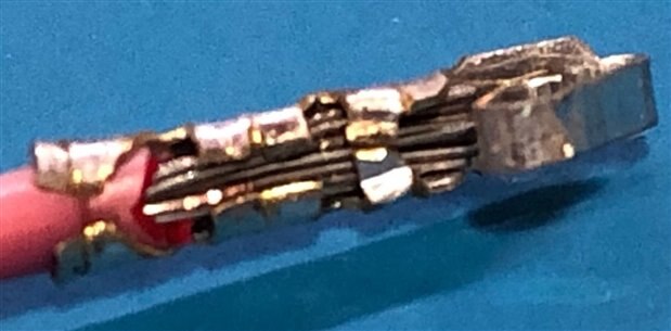

    0 Andrew J over 7 years ago in reply to shabaz
    Very useful pics, thanks Shabaz.  I figured out how the crimp tool works with Molex KK series terminals after a lot of head-scratching.  I suspect I may have the wire pushed too far forward, what do you think?  The wire itself is right on the border for size for that connector, but I've got some smaller gauge on order.
