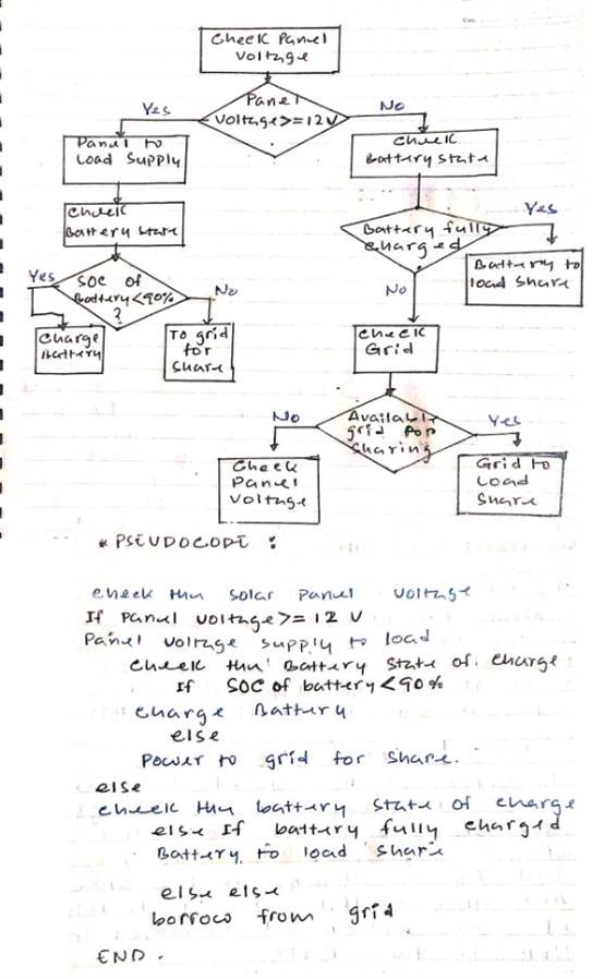

Hello guys, currently I am doing a project based on Power Sharing between Solar Home Systems by Smart Control of Power Flow. Any access energy will be share a common DC grid line (neighbouring PV system interconnected each other) based on a certain logic. I need to use a microcontroller which helps to control the power flow by certain simple logic below :
For a PV system, Initially, a microcontroller is checked the panel voltage, If panel voltage is available, then the solar panel will supply the load power. Also, the battery condition is checked simultaneously. If the state of charge of the battery is less than 90%, then the battery is also charged from panel voltage, otherwise, the excess panel voltage goes to the grid for sharing. In the meantime, If there is no panel voltage like abnormal weather and night times, the battery condition is checked and if there is significant charge in the battery, then battery supplies load with necessary voltage, else the microcontroller looks for available power from the grid to borrow where other SHS also interconnected. So voltage and the current sensor also included measuring the power how much send to the grid and how much (KWH or unit) take from the grid.
So now I need help, hopefully, someone will help me how can I start to code it in Arduino ....... or how can I model it MATLAB Simulink. I am looking forward to hearing someone

    OK, that is helpful. I am glad to see from a safety viewpoint the voltage we are talking about is ~12V. This is not to dissuade you, but understand that what you are undertaking may be challenging. For…

    OK, that is helpful.  I am glad to see from a safety viewpoint the voltage we are talking about is ~12V.  This is not to dissuade you, but understand that what you are undertaking may be challenging.  For example, if much current is involved and the distance is very far, the cable may need to be quite large.  And there could be many other hurdles along the way.
    The more definition you have before starting the more likely you are to succeed.  For example:
    • What battery technology to use - e.g. Lead acid, etc.  Realize that a lead acid car battery may have up to 14.5 V or so when charged.
    • How to tell the charge level of the battery.  See for example this link:  https://www.energymatters.com.au/components/battery-voltage-discharge/
    • Decide what Arduino to use - e.g. is it 5V tolerant or 3.3V maximum.  How many pins and what type will be needed.
    • Etc.
    Now break the problem into pieces and develop blocks of code for that piece.  Start with the block "Check panel voltage".  Set up a prototype on your bench using smaller batteries.  The Arduino can make analog voltage readings, but you will need to set up a voltage divider or something to get the voltage down to what the Arduino can handle.  Then in the loop the Arduino function analogRead() can be used to determine the voltage.  Get that working first and display the output to the serial port.
    Keep breaking it into pieces.  Let's say that next you code a if statement and determine the panel voltage and it is >= 12 V.  Then a method is needed to determine battery charge.  That is why the second bullet point above needs to be answered.
    And so on... What mechanism is going to be used to charge the battery?  Will the Arduino be controlling a relay or a separate board or what?  What will be the user interface and how will information be displayed?  All these questions need to be answered before coding can start.
    My advice is to get the best problem definition you can before going much further.

    In addition, I am attempting to model this algorithm in MATLAB regarding to analyze my project. May I have any suggestion from you

    0 fmilburn over 6 years ago in reply to sayed94
    I am glad I was helpful...
    I haven’t used MATLAB in quite sometime and don’t have a license for it.  But I would approach a solution the same way.  Start by thinking about what the physical system might look like instead of algorithms or MATLAB models.  Make a drawing which shows the battery and what you know about it.  Add the solar panels, charging, and instrumentation (and all pertaining information).  Draw the things that will be connected to it - eg lighting, water pump, etc. Estimate the power requirements so you know how large the batteries and solar cells need to be.  Show the connection to the network.  Add the control system with the Arduino to the drawing after you know what it will be controlling. Then start prototyping it piece by piece as described above. The same with MATLAB- once there is a good drawing you can start to model the pieces making sure each works as it is added.
    The most important skill for getting help on something like this is the ability to communicate technical issues.  This almost always means a drawing or sketch. Or in the case of programming a flow diagram, pseudo-code, or code snippets. If you do this others are much more likely to help.
