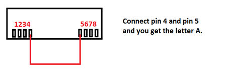

Hi,
Im using a transistor as a button that is pressing a button on  a  hacked keyboard.
Heres how the hacked  keyboard works (that is the small PCB iside the keyboard)-
Now what I want to do is use a transistor to connect the pins and get a letter.Heres how i did it .My questios is it correct couse im having some issues
with it like getting random letters or not getting any at all.

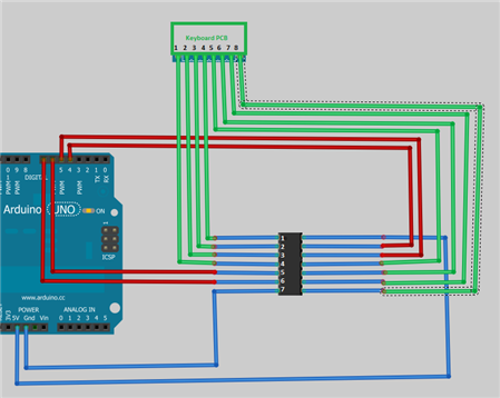

    0 YT2095 over 14 years ago
    it`s not a Bad idea, but the use of a 4016 or 4069 would have probably been better and more like an actual switch.
    you`ll have to get the timing right too (within reason) else you could either Miss the scan or hit it twice for instance.
    it May be an idea to also bias the transistors base down to deck to preclude any spurious triggerings/noise.

  • YT2095
    0 YT2095 over 14 years ago in reply to fustini
    well, this chip does have limitations in that there is a small resistance across the switch when "closed" and natually it`s current carrying capacity will be significantly less than that of a metal-on-metal contact (as in your relay).
    but they`re cheap enough, and worth carrying in your arsenel of parts even if it doesn`t quite work out for you in That particular application.

  • dirtdiver
    0 dirtdiver over 14 years ago in reply to YT2095
    I wont have any problems with the current right, its a keyboard after all image.. it cant be using more than 20-40mA per button ..i think

  • YT2095
    0 YT2095 over 14 years ago in reply to dirtdiver
    so as to be without bias, here`s the 1`st on ebay I found just:rhttp://www.ebay.co.uk/itm/2x-CD4016-HCF4016-Quad-Bilaterial-Switch-C-MOS-IC-/180710504134?pt=UK_BOI_Electrical_Components_Supplies_ET&hash=item2a132f76c6
    and no, you could drive several keyboard switches with a single switch, you`ll be fine image

  • dirtdiver
    So the wiring should look like this right
    Connecting 1 with 2 , 3-4, 5-6 , 6-7, (keyboard PCB)
    And is the GND and Vin correct for the 4016?
