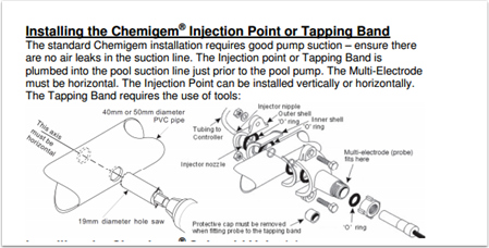

    0 e14 Contributor over 14 years ago in reply to ntewinkel
    HI Nico,
    the probe is large-ish ( but this is normal for these chemical sensors) In a swimming there are plently of pipes hiden in the filter enclosure
    I modified a comercial solution to insert the probe into a pipe as below. the fitting cost $55 AUD but as the comercial Ph controlller cost welll over $1500 aud. I'm well ahead on the project. (+ I'm having a lot of fun adding web interfaces and monitoring)
