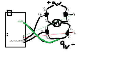

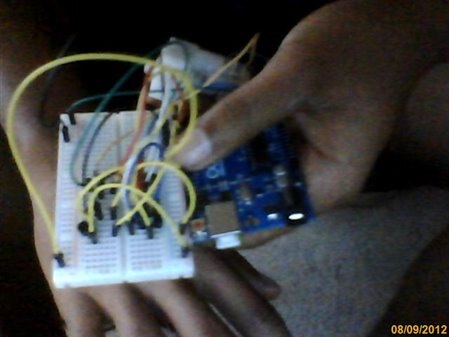

Im trying to wire thish bridge circuit from http://www.robotroom.com/BipolarHBridge.html. I dont have the diodes because it a low voltage. When i plus the 9v battery into the power bus on the side of the breadboard the arduino powers on. I dont know if its supposed to do that.I want the motor to run off of 9v but controlled by the 5v arduino logic and transistors. What did I do wrong. this is how i wired it imageimage

    Hi
    I would suggest putting the catch diodes in, you are probably getting spikes from the motor affecting the IC. Even better, use one battery for the IC, and another for the motors. Make sure to connect the grounds together....
    Good Luck!

    just posted this to my blog. Hope it helps.http://2.bp.blogspot.com/-NQvpdsRyugY/UDFzjropW8I/AAAAAAAAAP8/mumXXe7z5lc/s1600/Hbridge.jpg
