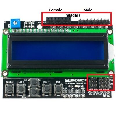

Hi Everyone,
I'm new here and just purchased the lcd shield from dfrobot.  Now that I've finished the programming I'm ready to connect some inputs.  I need to use digital pins 10-12, 5v and ground on my arduino uno.  I'm sure I have to solder the connection on the lcd shield, but I want to make sure before applying the heat (I have very limited experience with soldering).  I was hoping to find a video show exactly how to do so, but have not found anything on youtube.  Can someone help me out?
Thanks,
Onyx

    If you have the DFrobot LCD keypad sheild V1.0 the pins Allocated pins are Digital pins 4-10 and Anolog 0. So you'd have to use a different pin then D10, here are the Shematics for the shield and the Manual. Mark has the right good advice about soldering but I'd suggest soldering male or female headers on the shield for easier prototyping, hope this helps.

    This is great, but I am looking to put this as part of a working project.  Having the connections above and close to the lcd is a problem I am trying to over come.  I would like a way to get the connections from under shield....and over the uno.  I'm thinking I can put connectors on a proto-board above and below to accomplish this.  I would like a better solution.

    If thats the case you can always just solder the wire stright on to the pads on the sheild under or over it, just remember D10 is being used by the sheild. If you don't want to go straight and solder on the shield practic on these protoboards. One you've got the hang of it move on to the LCD sheild. just solder the wires to the same points you would have the headers, like i said over or under it wont matter. Hope this helps.
