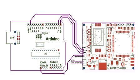

I am new to arduino programming and electronics. So I am having problem trying to figure out what to put where.image Please tell me if there is anything to be done to improve and also if there is any mistakes in code or poor programming practice.
I have an arduino mega 2560 board connected to a GSM sim 900 module. I need to send text messages from the GSM module.
Hardware connections: VCC of GSM connected to 5Vpin of mega. V interface pin of GSM is supplied with same voltage as microcontroller (from Vin pin of mega) as specified in its manual. TXD of GSM is connected to RX3 of arduino and RXD of GSM to TX3 of mega board.
Problem :
I am able to send blank text messages with the program I have. But when I insert a new statement to enter text into message body, GSM module do not send message. The instructions to be send to GSM modem is:
AT+CMGF=1 // for setting GSM modem to text message mode
AT+CMGS="<phone number>" text message <enter>

Do I have to print the text message some where else? Or is there any mistake in this code? Any pointers would be much appreciated.
  • ntewinkel
    0 ntewinkel over 13 years ago
    Hi Liza,
    I think the problem might be that "enter" is often two characters (Carriage Return and Line Feed).
    Instead of writing the ASCII characters, try this:
    Serial3.write("\""); // backslash before the double quote means it's part of the string
    Serial3.write("\n"); // enter
    You could also try sending it to the serial debugger screen to see what is actually being sent.
    Hope that helps!
