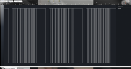

Hi
I would like to control my A/C (Air Conditioner) using Arduino Uno
so first I hooked to Pin 11 IR Receiver (TSOP4838) and using IRremote Lib I got the ON and OFF Command
ON Command:
Decoded NEC: B335A162 (32 bits)
Raw (68): -22790 8350 -3450 550 -1600 600 -500 550 -1550 600 -1600 600 -500 550 -500 550 -1600 600 -1550 600 -500 550 -500 600 -1550 600 -1550 600 -500 600 -1550 600 -500 600 -1550 550 -1600 600 -500 550 -1600 550 -500 600 -500 550 -500 600 -500 550 -1550 600 -500 550 -1600 600 -1550 600 -500 600 -450 600 -500 550 -1600 550 -500 550
OFF Command:
Decoded NEC: B335D162 (32 bits)
Raw (68): 4730 8400 -3400 600 -1550 600 -500 600 -1550 600 -1550 600 -500 600 -450 600 -1550 600 -1600 550 -500 600 -450 600 -1600 550 -1600 600 -450 600 -1550 600 -500 600 -1550 600 -1550 600 -1600 600 -450 600 -1550 600 -500 550 -500 600 -450 600 -1600 600 -450 600 -1550 600 -1600 550 -500 600 -450 600 -500 600 -1550 600 -400 600
In addition I hook to PIN3 IR Led (TOIR-30A94)
using SendNEC of IRremote lib I tried to send the commands without luck (I even tried to send the raw data using sendRaw)
the A/C just not performing the commands.
I verify using cellphone camera that the IR led does light when I send the commands.
also I tried with my DVR commands and it works, but with the A/C it does not.
I attach an image of my system layout.
Can someone help? point to what can be wrong?

    I got a logic and I capture the IR Recevier Data from the Remote:
    it seem like the remote Transmit 3 Times.
    let say it transmit code A, then the flow is:
    1) Transmit A
    2) Transmit Invert A (NOT A)
    1) Transmit A
    I tried to replicate it with my IR LED Still, NO lack....
    I even compare it using the IR Receiver... and it looks the same.
    I still don't know why, it is not working.

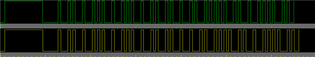

    0 mcb1 over 12 years ago in reply to baget
    To my eyes 1 and 3 aren't the same.
    I'd be doing some digging using google, and looking at the various forums.
    You may find someone has already done the necessary.
    Apologies I hadn't blown it up ....ooops.
    Presumably the bottom of the trace is when data is received.
    To me it seems there is a 'wakeup' of approx 8mS then a long space of three pulse widths, followed by a single pulse then a space.
    If this is right then you have mark, space, mark, mark, space, mark, space etc. OR
    1011010111010111010110110101101101110110101111011 which in hex is 16BAEB6B6ED7B
    Yet the second data is wakeup, long space, mark, mark, space, mark, mark, mark, space, mark, space mark, mark, mark OR
    1101110101110101110110111011011010110111010101101   which in hex is 1BAEBB76D6EAD
    Both are 49 bits of data, which may equate to 1 start bit and then 6 x 8bit words or 6 bytes
    This could be
    1 01101011 10101110 10110110 10110110 11101101 01111011 (6B AE B6 B6 ED 7B)
    1 10111010 11101011 10110111 01101101 01101110 10101101 (BA EB B7 6D 6E AD)
    It could also be that there is x bits for command and then x bits for a data payload
    I suggest a few other samples may help to see some form of pattern.
