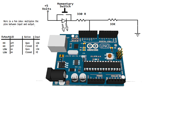

  • billabott
    0 billabott over 12 years ago
    Click on image to open a higher resolution view.
    Q: Were these 10 LEDs going to  be low current (2 mA)  SMD type  or were you planning on 25 mA super bright 5mm LEDs?     All on at the same time is pulling 250 mA just for the LEDs .....
    Found at Arduino forum:
    "Bear in mind that 200mA is the absolute maximum for the PROCESSOR; not just the things connected to it.  That means you need to account for the current the processor itself uses (about 30 mA)."
    Coding Badly image

    0 mcb1 over 12 years ago in reply to billabott
    Nice idea
    However its confusing enough now for new users, without having to switch rapidly between input, and output modes.
    Especially if you multiply it by 10 (or 12) .....
    BTW I have yet to see why you need to drive most LED's beyond 10 or 12mA.
    Sure if you are using them as a torch, but not in general useage, as modern LEDs are Extemely High brightness compared to 5 or so years ago.
    Most are painful to look at, and the contrast of the background/surrounding mounting can have a major difference.

  • billabott
    0 billabott over 12 years ago in reply to mcb1
    Agreed.   So if the proper resistors are installed to limit current to  10 mA per LED -  Aal izz well.
