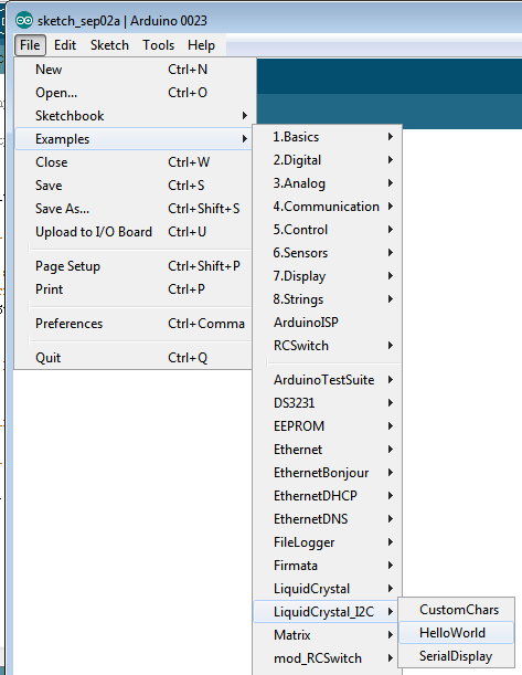

I have some problem with geting my code to work after a changed my LCD from a 16x2 to a 20x4 with I2C inteface.
If i try the sample code below the new LCD works:

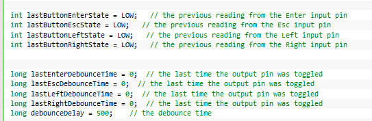

int lastButtonPushed = 0;
int lastButtonEnterState = LOW;   // the previous reading from the Enter input pin
int lastButtonEscState = LOW;   // the previous reading from the Esc input pin
int lastButtonLeftState = LOW;   // the previous reading from the Left input pin
int lastButtonRightState = LOW;   // the previous reading from the Right input pin
long lastEnterDebounceTime = 0;  // the last time the output pin was toggled
long lastEscDebounceTime = 0;  // the last time the output pin was toggled
long lastLeftDebounceTime = 0;  // the last time the output pin was toggled
long lastRightDebounceTime = 0;  // the last time the output pin was toggled
long debounceDelay = 500;    // the debounce time

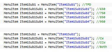

MenuBackend menu = MenuBackend(menuUsed,menuChanged);
//initialize menuitems
    MenuItem Item1 = MenuItem("Item1"); //Motor 1 Settings
  MenuItem Item1Sub1 = MenuItem("Item1Sub1"); //TPD
  MenuItem Item1Sub1Sub1 = MenuItem("Item1Sub1Sub1"); //650
  MenuItem Item1Sub1Sub2 = MenuItem("Item1Sub1Sub2"); //750
  MenuItem Item1Sub1Sub3 = MenuItem("Item1Sub1Sub3"); //850
  MenuItem Item1Sub1Sub4 = MenuItem("Item1Sub1Sub4"); //950
  MenuItem Item1Sub2 = MenuItem("Item1Sub2");
  MenuItem Item1Sub2Sub1 = MenuItem("Item1Sub2Sub1"); //CW
  MenuItem Item1Sub2Sub2 = MenuItem("Item1Sub2Sub2"); //CCW
  MenuItem Item1Sub2Sub3 = MenuItem("Item1Sub2Sub3"); //Both
  MenuItem Item1Sub3 = MenuItem("Item1Sub3");
  MenuItem Item1Sub3Sub1 = MenuItem("Item1Sub3Sub1"); //Stop
  MenuItem Item1Sub3Sub2 = MenuItem("Item1Sub3Sub2"); //Start

    0 mcb1 over 12 years ago in reply to e14 Contributor
    Filip
    Ram issues are a pain.
    You can save yourself some memory if you change the variables to something more suitable.
    The first 4 are simply on or off so could be a boolean.
    The debounceDelay doesn't require to be a long.
    You seem to have a lot of text that could be saved into a single variable and then reused each time you want to display it
    The "Item1Sub" is used extensively and only needs to be stored once.
    You could also make up the text with adding the numbers if you still need more room.
    Theses parts here look for a variable text then print the same text, when you could simply print the variable (you already checks is that)
    Line 4 (0,3) of you display mostly seems to print 5 chars  ie CCW or CCW * (CCW space *)
    You don't need to print the whole line, and could also just print the * by using
    lcd.setCursor(4.3);
    lcd.print("*") ;
    So you may be able to tidy what you have and save enough memory to get it to work.
    Filip
    A quick reply.
    Your code is looking tidier up until line 189, where you could easily save more ram by not duplicating the text and LCD print.
    You may need to clear old text on a line, but you shouldn't require to do it each time.
    Do it once then add the appropriate new chars.
    I suggest printing it out and highlight the common text to see how you could save more ram.
    the keys become very sensitive
    You'll have to qualify 'sensitive' .. do they operate quickly so you end up with the wrong choice, do you have to hold them from a while to have the menu change?
    You seem to have 500mS for the debounce time (line 28) which is far too long IMO

    Mark, about the sensitive keys.....
    They operate quickly so ot end up with the wrong choice in the menu.
    But it's only after I have done one choise... with other words.
    First time I browse in the menu it works great and if we say that I choose to change the backlight and then when I try to change it agian the menu is operate to quickly and I end up with a wrong choice in menu.

    Another observation is the menu system
    It is ALL going to be in RAM and take a huge amount of it too, all those strings add up real fast, never mind the management of the link list to allow you to manage it, what MPU are you running this on, an ATMEGA328 (UNO) or MEGA ATMEGA2560 ?? and you done apear to be using all of them, just declaring them, delete or comment out the ones your not using.
    the video should show you alternate approach
    can yo sketch what your trying to achieve with this, maybe a picture of the menu and layout of the system etc
    I will then along with Mark be able to suggest some good fixes
    0 e14 Contributor over 12 years ago in reply to Robert Peter Oakes
    I have an UNO (ATMEGA328)
    The project I'm doing is my own watch winder with 2 slots.
    I don't know how much you guys know about watch winders but depending on the watch it supposed to turn X turns per day (TPD) and in different directions.
    In the end it's going to be an advanced version of the one you see in the picture link below.
    http://livedoor.blogimg.jp/a_lange_sohne/imgs/1/4/14156f10.jpg
    My "watch tube" will be black with a white line, which will register(thanks to a line sensor) the number of turns it has taken.
    I have just start the project and my first milestone in to get the code to work before I start to buy every things else.
    And I am doing the code step by step before I add more things to it, and as you know you can see where I am now.
    I don't know if I have like you say in Swedish.. "Taken water over my head" but I like to have some challenges when my girl is watching crap on the television.
    I want the menu to look like a list but i didn't achieve that by myself that why I used the Menubackend-lib.
    To navigate in the menu I want to use a rotary encoder, one select button and one back/esc button.
    Here is a menu sketch:
    Motor 1 settings
         ->TPD
              ->650
              ->750
              ->850
              ->950
         ->Direction
              ->CW
              ->CCW
              ->CW&CCW
         ->Start/Stop //manual inactivate the motor
              ->Start
              ->Stop
    Motor 2 settings
         ->TPD
              ->650
              ->750
              ->850
              ->950
         ->Direction
              ->CW
              ->CCW
              ->CW&CCW
              ->Start
              ->Stop
    Backlight //I do not know if I really need this, so I will maybe remove this to save RAM
         ->25%
         ->50%
         ->75%
         ->100%
