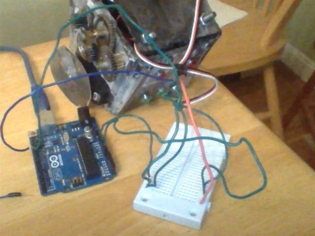

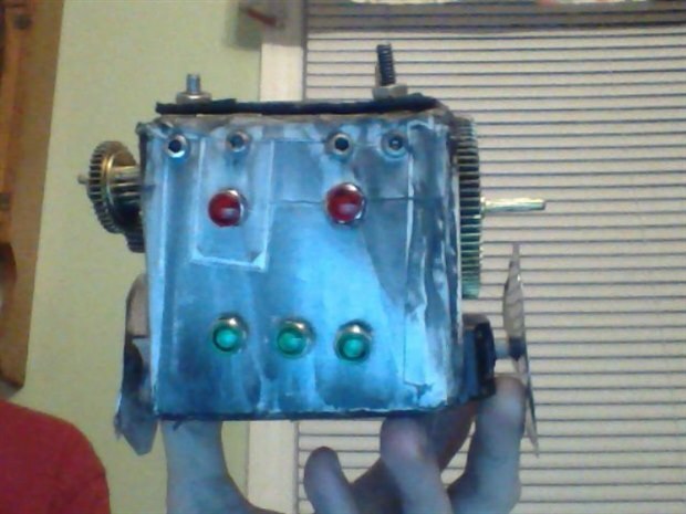

You should know I am trying to drive two servos and one ir sensor with arduino uno. The ir sensor will be used to make my steampunk robot RC while the servos will drive the robot. Also you should know that one servo moves the other one doesn't. The servo connected to pin 12 will not move which is the left servo. I know this servo works because I have tested it several times. Also I think it is a problem of PWM because power and ground pins are clearly working. Can arduino uno drive two servos or not because it says nothing in the datasheet.

    The code you provide makes no calls to any of the move commands with the exception of the one from startup() so it most lightly will just sit there after the initial move (Depending on the servos)
    what servos are you using, provide picture, make  and model number
    provide detailed and clear picture of the schematic your using so we can verify the wiring
    also there is no code to handle the IR receiver
    what is on pins 9, 10, 11 ?
    Please provide all the code if you have it, if not then that's your problem.. missing code

    The servo you linked in looks like a standard remote model servo and is designed to have a limited range of perhaps 270deg rotation, these are not for continuous rotation required to drive a wheel for example. The one you may want to consider is more like this if it is for driving the wheels
    http://www.radioshack.com/parallax-continuous-rotation-servo/2730457.html
    Powering the servos from the pins of an Arduino is NOT recommended, the pins can only provide about 10mA and will be a little less than 5V, most servos, even small ones will consume significantly more than this and can be in excess of 100mA
    Powering an LED is ok as this often only requires a few mA to work for the small LEDs and providing a limiting resistor is included
    If one of your servos is already rotated to its max in one direction, telling it to go to 360deg will result in no rotation
    Try setting them both to 10deg first, wait a couple of seconds then send a new rotation command of say 180deg
    Hope this helps

    Thank you peter but I have one more important question. Since I am already using the 5V pin then what pin can I use to power the servos?
  • Robert Peter Oakes
    0 Robert Peter Oakes over 11 years ago in reply to nschreiber0813
    Can you solder, if so make up a breakout connector from 1 wire to many
    If not connect them via a breadboard

    Thank you for your help. You should know I have finally found a bread board and I finally managed to use it for my robot. Merry Christmas and Happy New Year even though it is a little bit early.
