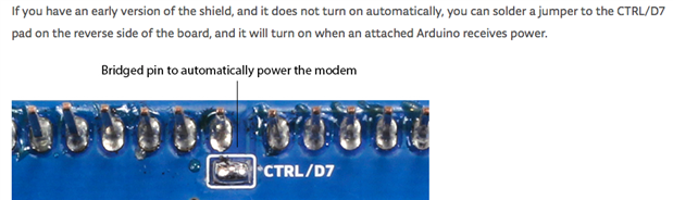

    AHA! http://arduino.cc/en/Guide/GSMShieldLeonardoMega

  • gadget.iom
    0 gadget.iom over 11 years ago in reply to markvenn
    You're most welcome! image
    Please let me know how you get on...

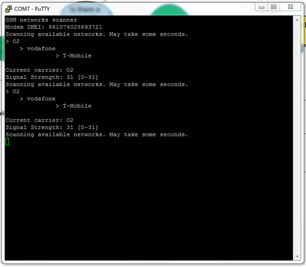

    Success! The power supply is definitely an issue, so this needs to be taken into account, not going to get this to run "standalone" for very long at all I think image
  • markvenn
    0 markvenn over 11 years ago in reply to markvenn
    Strange that it is only showing these three and not the set that my mobile show but I am working on the assumption that the antenna is not not the quality of my Galaxy.
