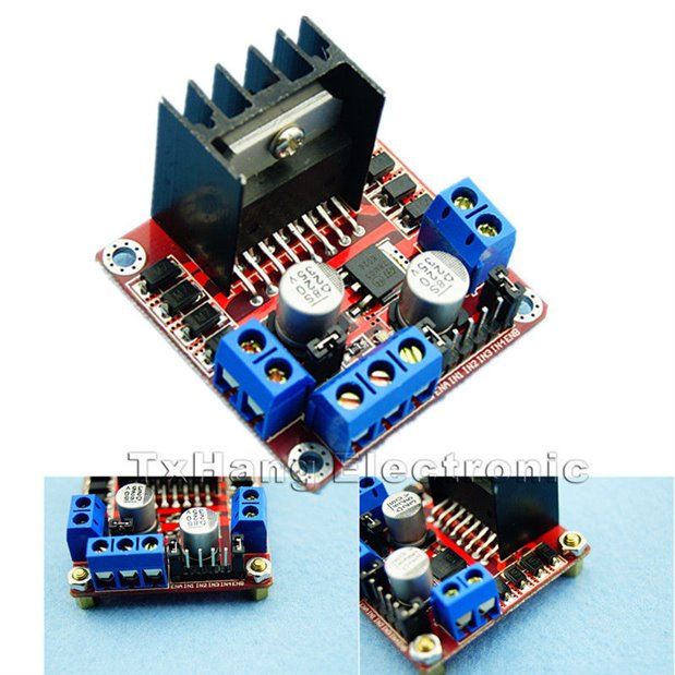

  • muffenme
    0 muffenme over 10 years ago
    Each motor needs 2 MOSFET to protect your arduino board or you can get a board design to work with arduino to control motor. like http://www.ebay.ca/itm/Stepper-Motor-Drive-Controller-Board-Module-L298N-Dual-H-Bridge-DC-For-Arduino-/170926726867?pt=LH_DefaultDomain_0&hash=item27cc06ded3.  The link was added March 10, 2015.image
