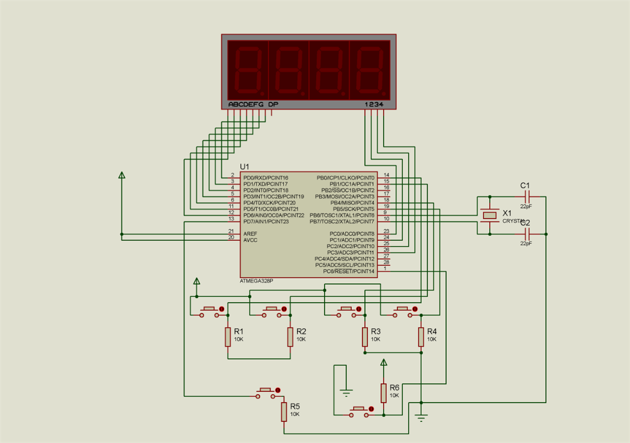

I have made the following circuit, can anyone please tell me why the seven segments are flickering. I have used multiplexing, don't tell me it is because of that. I have tried it prototyping on an arduino uno and it worked perfectly.SO its not because of the multiplexing!! and its not the code. I think something is interfering or resetting the microcontroller because it does not store the values on the seven segments.The motors on the right are not connected. Any clue what is wrong?

    This is the circuit ................. i am trying to upload the video........it will be up soonimage

    Again ... I am not an expert in circuit interpretation but I don't see any GND connected to the LEDs...

    If your schematic is accurate the complete absence of any decoupling capacitors won't help.
    You need at least 10uF + two or three 100nF ceramics close to the processor from VCC to ground.
    Unless the LED display has built in current limiting resistors you should put a resistor in each of the segment connections to limit the current.

    This has echos of this post, where the same circuit worked when the servo was disconnected.
    http://www.element14.com/community/thread/42034/l/servo-problem
    Despite several people helping, you stopped replying on the 27th, yet this new post suggests the problem wasn't resolved.
    I see several problems if this is built as shown.
    1.    The ground from R1, R2 is missing....I'm assuming its is a simple error of the schematic, but maybe not.
    2.    I see no capacitors across the supply. and especially the digitally noisy 7 seg LED's.
    3.    Pin 13 (PD7) is floating, so either the schematic has another error, or that is the way it's been wired.
    This battery is driving the microcontroller and 2 pwm servos that will be connected at pins  16 and 17
    In nearly every 'HELP' call when servos are included the OP has failed to add a 1000uF capacitor or power the servos separately, and this has been the cause of various issues.
    Does it perform Okay with the servos disconnected.?? (Your previous post suggests the answer is YES)
    I might help if you include your code, however I do think its is a supply issue.
    In future it is always beneficial to those trying to help to include ALL the schematic.
    This includes the Regulator, Filtering capacitors, and connections to the device ...7 seg LED's PWM Servos.
    Enrico is correct the ground connection is not shown on this schematic.

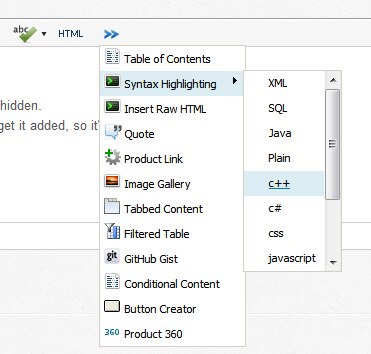

    The syntax highlighting that Enrico is referring to is a little hidden.
    It's a shame there isn't a simple icon, but we struggled to get it added, so it's better than nothing.
    past you code, then highlight it all and
    Select the >> symbol, then Syntax Highlighting, then C++
    It does have issues with blank lines, and tries to make it Excel, but I'm sure you'll sort it out.
