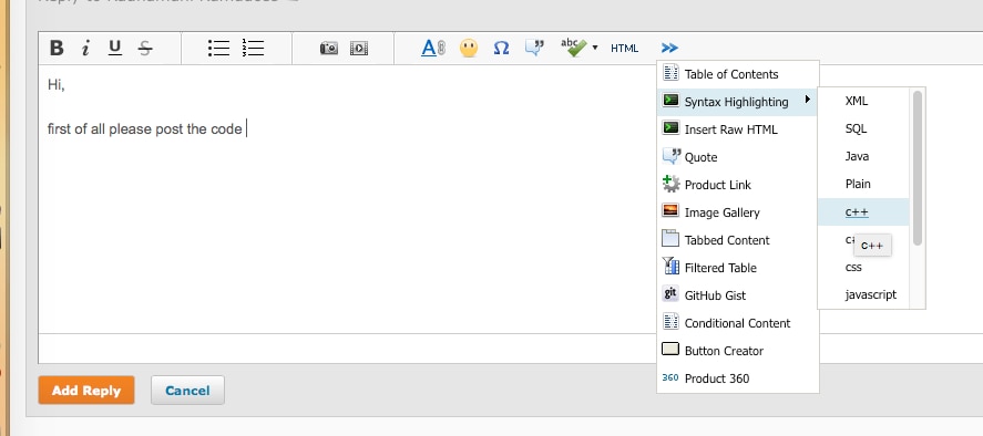

    Hi,
    first of all please post the code selecting Syntax Highlighting as shown in the following image else it is impossible to copy and past the code in an ide and eventually see what's wrong to help you.
    Thank you. Enrico
