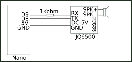

I restored the module using the toolset in Linux and then plugged the module it into a MS Windows operating system computer. It displayed the module as a CD ROM drive. In Linux I couldn't find the module  in the filesystem so I relied on the MS O/S EXE to put sound files on the card. You can load sound files on the card in Linux. I haven't tried that yet. Again it is command line.
Fast forward....Does it work?
Using the above drawing for a hardware configuration and https://github.com/sleemanj/JQ6500_Serial Arduino modules I was able to run examples provided except for one that used the file number. It is specific on how the files need to be identified. I may have an error that is causing the problem. Yes, I know it is not a good idea to use the Arduino to power external devices. It was down and dirty and it worked. That again is simple:)
I also confirmed the operation of the K# trigger pins. If you short the pin to ground the module will play a specific file. This is real easy to use in an Arduino sketch. You don't need the Arduino module to communicate with the module. You don't need serial com pins and setup to work. Just ground an Arduino pin connected to a K pin and sound plays. Now that simple!
