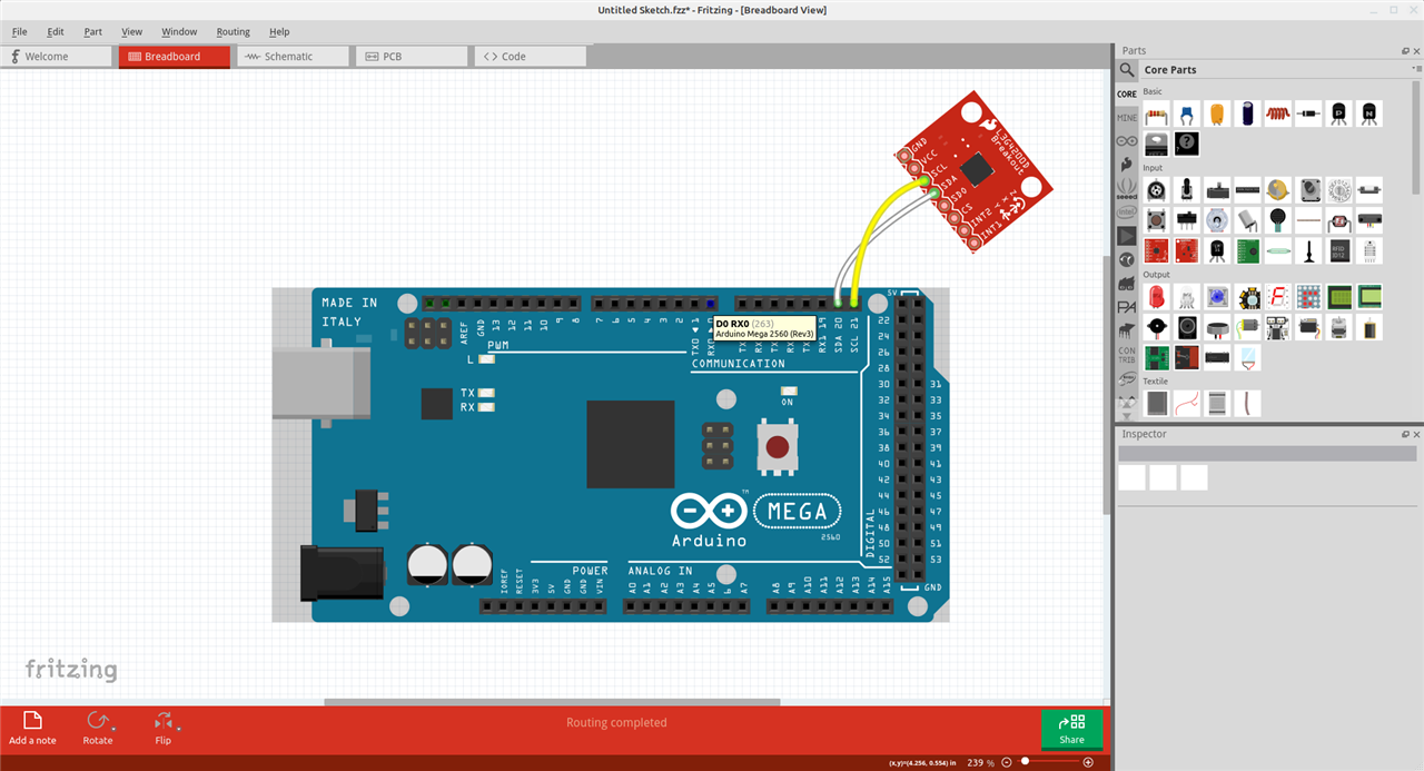

  • BigG
    BigG over 4 years ago

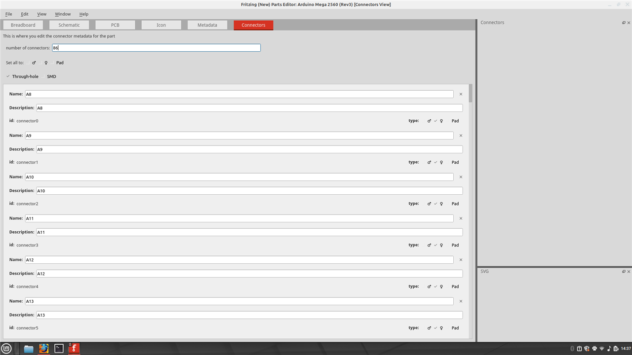

    I've found time and time again that Fritzing is my friend when it comes to working out which pins to use. This is a quick and easy way to work out your pin combos using the Breadboard option.
  • BigG
    BigG over 4 years ago in reply to BigG
    And if you want to add in reminders of what each pin will do, or customise the pin reference to suit your level of understanding, then you can modify the board's connector descriptions using the Fritzing part editor - and then this will save the board as a new part for you to use:

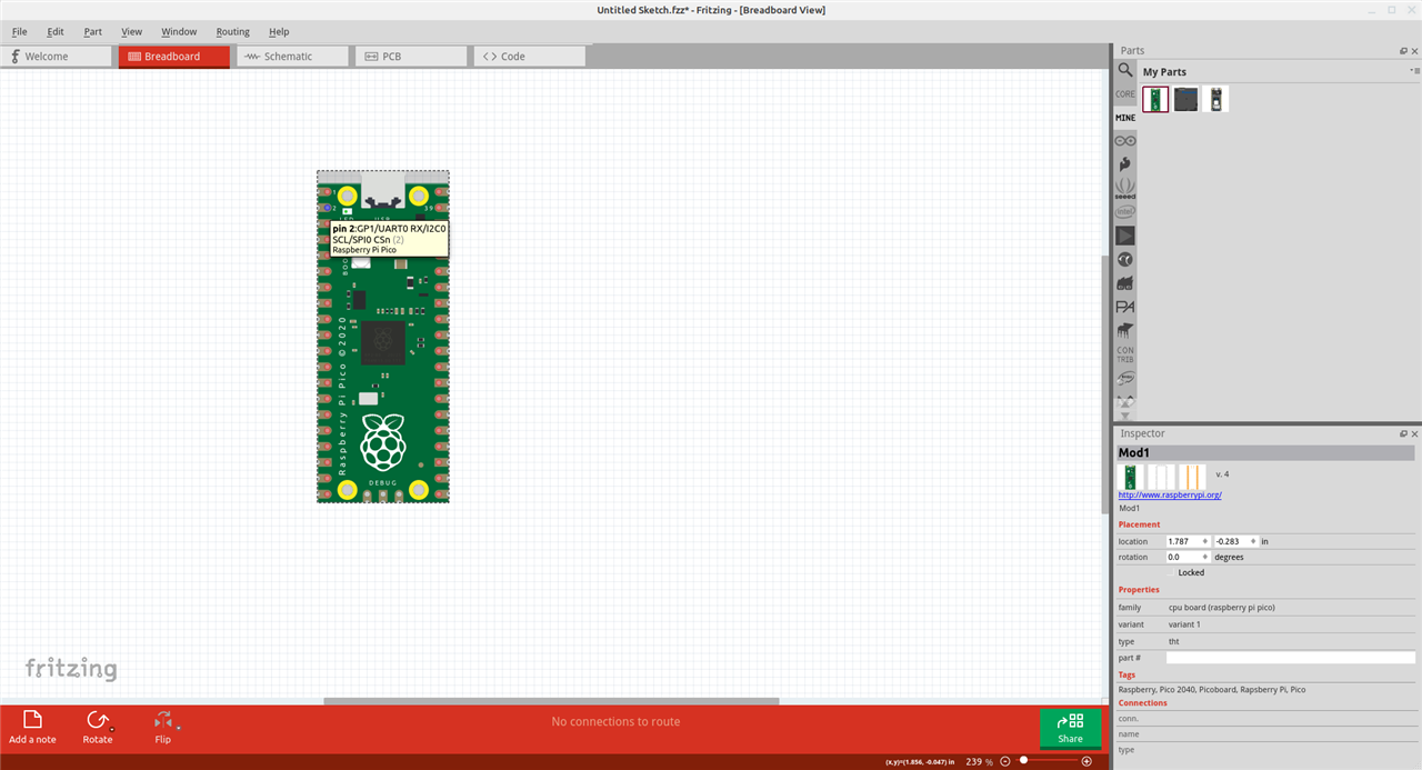

  • BigG
    For example, this Raspberry Pi Pico board has put the "Description" field to good use by describing what the pin does. You can see this detail when you hover over the pin.
