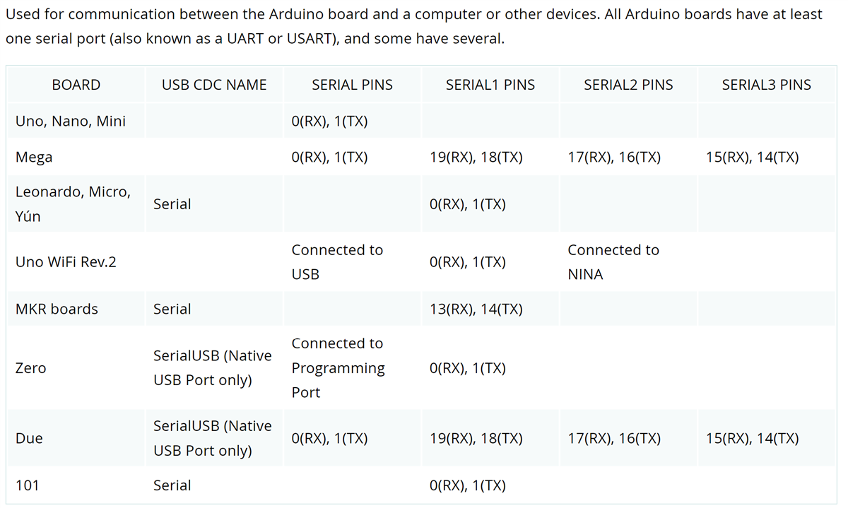

    I've been caught out with this type of problem when using the Arduino IDE with a board I'm unfamiliar with so I can relate. In your case, the pins with the labels 0 and 1 on the silkscreen will cause a conflict since they also have RX and TX beside them which are used for the serial terminal.  The Arduino reference documentation (as well as the material Dave linked) covers this as shown in the excerpt below.
    But even here they don't state that pins 18 and 19 are set up using Serial1 as opposed to plain Serial for pins 0 and 1.  For that you have to look in the Serial.begin() documentation and it is also shown on the silkscreen.  So the information is spread about.
    The Arduino documentation is pretty good about specifying these things for the Uno in the documentation but the further you stray from that model the less likely that is to be so.  There are so many different processors that use the IDE now (many not even developed by Arduino) it isn't possible to cover them all in one place and it is necessary to pay close attention to the board pinout.  By the time you get to some of the Espressif boards, all bets are off.  Some of the silkscreens are awful and there is only generic information at best.
