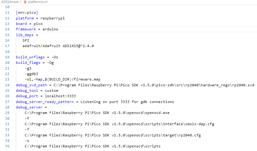

I am using a RPI Pico running the arduino framework using platformio
Here is the code I put together using Adafruits arduino library for the ADS1115

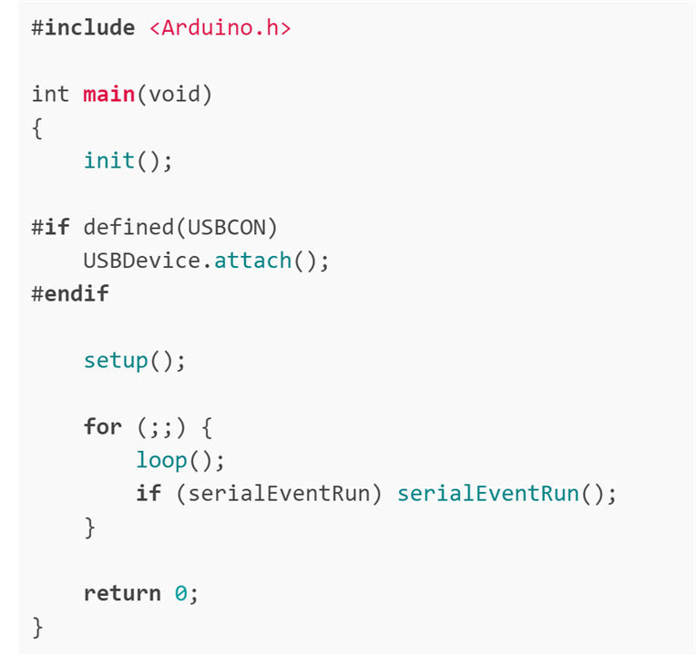

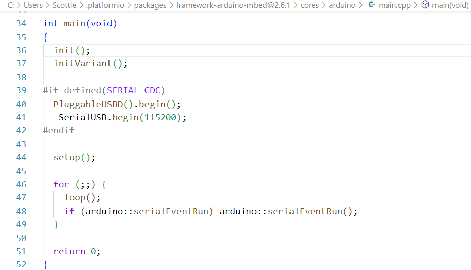

    Thanks for the kind words :) I'm not an arduino expert, so I don't know much about how to best structure a program with the loop function. It appears quite similar to other Microcontrollers where I would run an endless for loop in main, so I don't know...
    I have nothing against the arduino IDE, its a great place to start. I am using platformio in VScode, so no cmake, make, linker scripts, etc to deal with just KISS.
    I had to setup the picoprobe on my own, but hopefully that will work out of the box eventually...

    Jan Cumps over 3 years ago in reply to scottiebabe
    It is virtually the same. The Arduino lib implements main(), and:
    • first calls setup() - this will run your setup() code
    • then loops for ever and calls loop() in that loop - this will run your loop() code
    source: https://forum.arduino.cc/t/why-there-is-no-main-function/284675/3
