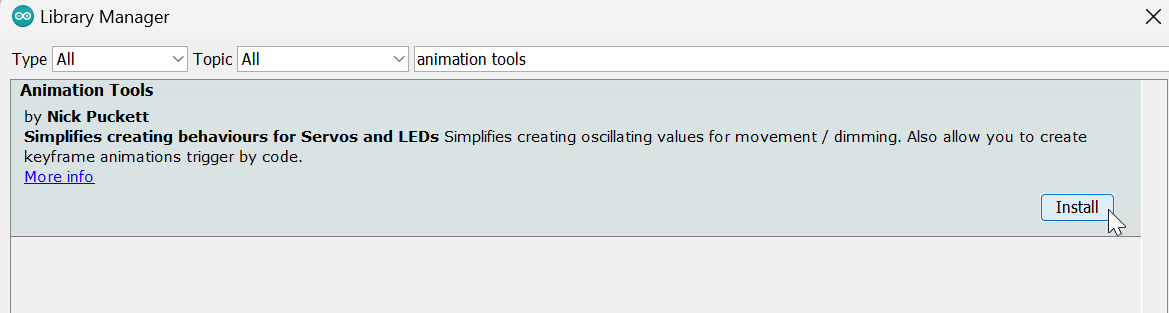

    Anyway, I had a look and there are various ready-made libraries that could help. Not all the libraries will require the PCA9685; some will require the servos to be directly connected to the Arduino GPIO pins.
    Since I have an Arduino Mega, I thought I'd give one library a quick try.

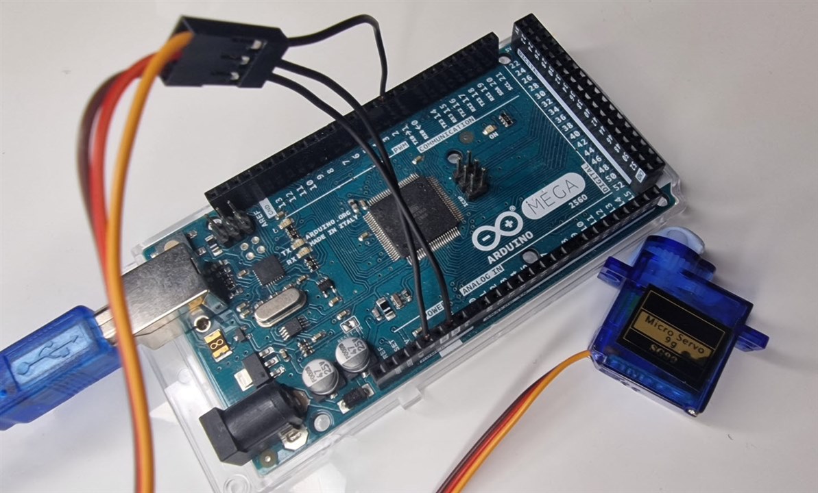

    I assumed there were 6 servos for my quick test.
    I decided to connect the six servos directly to Digital pins 2-7, i.e. no PCA9685 chip used:

    Now the main loop is very simple. All it does is forever go through each timeline, to see if any servo position needs updating, and it performs the update.
    The entire code is here, which you could examine and modify to suit your needs, it is also pasted below.

    I have tested it with a single servo, just manually patching it into Digital pins 2, 3, 4 etc., and it seems to work. But I know nothing much about this library, so you'd need to experiment with it to see how to adjust it to your needs. Maybe you could offload some of the animation effort by building a simple testbed and telling the modeller to write the three arrays, i.e. eventTime, eventPosition and travelTime, i.e. show the modeller where to click to build and upload the code, so they can quickly tweak the arrays and see the results.
    The photo of my test setup is above.. really crude, and would need a better supply for more servos! I used just the USB connection to power the single servo for now.
