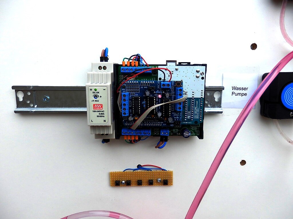

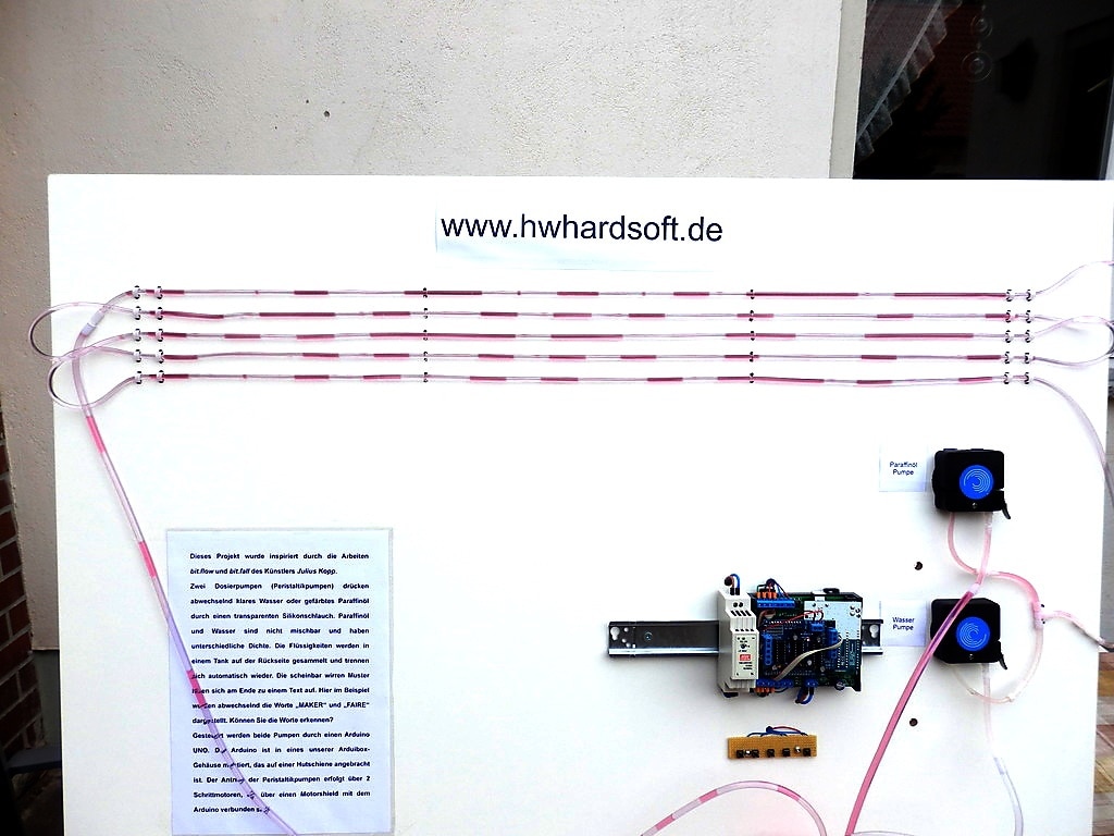

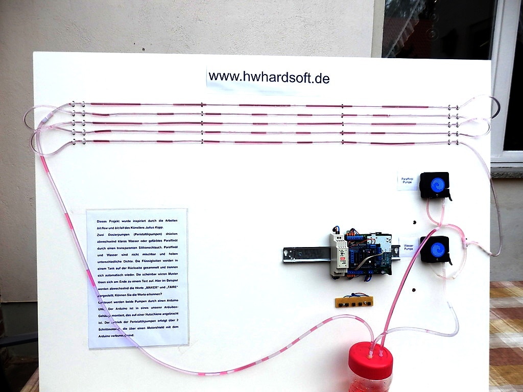

Hi,

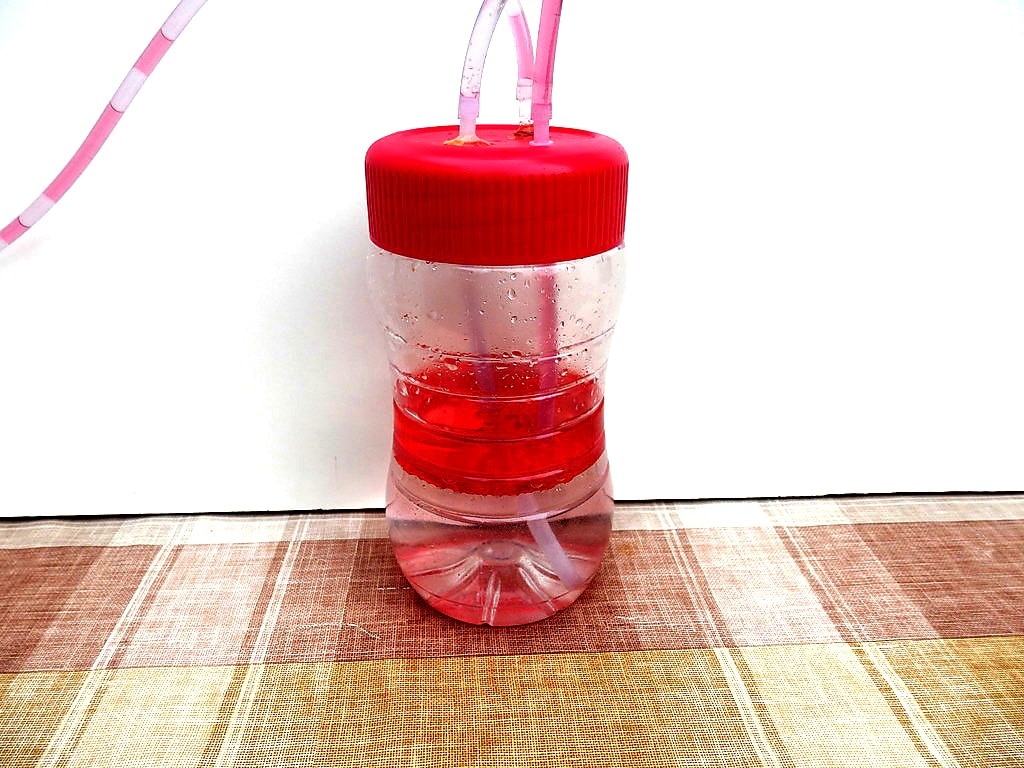

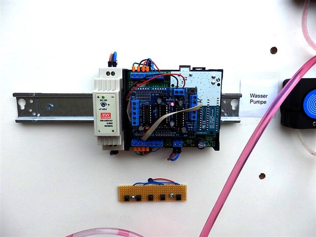

I want to introduce this  demo project for the Maker Faire in Hannover last weekend. The project was inspired by the work of the artist Julius Popp. We are using a transparent hose, 2 peristaltic pumps and an Arduino Uno with motor shield (both mounted in an Arduino Din rail enclosure ) to build a simple display.
The pumps pressing a pattern of water and red paraffin oil in the hose. In the end a text will be visible. For the Maker Faire we've used 2 alternating texts "Maker" and "faire" (see the picture below).
Source code and additional infos are available on our website.

    beacon_dave over 9 years ago
    If you used separate pumps/valves for each row, then you could presumably make quite a long scrolling news ticker at a relatively low cost compared to other technologies.
  • hwhardsoft
    hwhardsoft over 9 years ago in reply to beacon_dave
    Yes this is possible, but you will need 2 pumps per row in this case. The price for such an pump is 39€ - for 5 rows you need 10 pumps = 390€. Its an expensive solution ....

    balearicdynamics over 9 years ago in reply to hwhardsoft
    Frankly now the text is more readable. How much complex was in this context to use a bit larger tubes (that means, I know, more liquid and probably a more powerful peristaltic pumps)?
