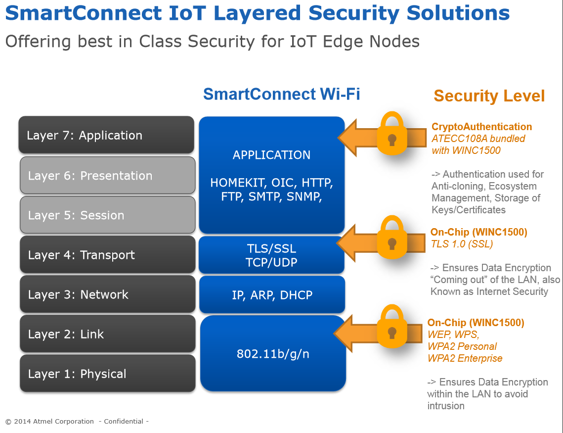

Whilst working with the Arduino Yún on the Enchanted Objects challenge I looked into securing the connection using HTTPS with TLS data encryption (which was straightforward) and validating the certificates (which was not). Although my Yún based solution did work there is an issue with the boot time and power consumption.
Since then I've been searching around the net for alternative solutions that were equally secure and stumbled upon the ATWINC1500 ATWINC1500
From: http://www.em.avnetasia.com/Admin/Product/DownloadCenterFiles/8bc93bd9-cbe6-4400-be94-a99a178b9e37.pdf
A bit of further searching showed that the module is being put into a shield format with an additional secure memory chip, here's a prototype from last year WINC1500 | Hackaday and it's also listed on the Arduino store http://store-usa.arduino.cc/products/asx00001
That's something to look forward to.

    frankly I had no idea that a similar module was already existing for the Yun but it is not uncommon that with slow processors and micro controllers VS computers the remote communication is secured with an encryption IC. There are many and the same Atmel, but also Nordic and NXP produce good ones at a very low price.
    Another more flexible approach that I have already used in past for a very tiny linux board developed for the Nintendo WII II (was running OpenWRT linux distribution) is based on the FPGA, eventually in conjunction with and encryption IC. In this way there is the advantage of a very high flexibility in the firmware / software development always keeping the security level at a very high standard.
    Last but not least - referring to some previous posts about the costs of the trusted certificates respect the untrusted open cert - this is a low-cost reliable method without the need of a certification authority for data encryption.
    In one of my previous lifes when I was a Alcatel network specialist I remember that this is just the most common method that the high-end WAN networking Cisco devices uses to grant the highest security level (e.g. in the PIX Cisco Firewalls and the big routers collecting data through the SNMP protocol).

    Enrico, the Yún is effectively an Arduino Leonardo with a OpenWRT router soldered on the top, the problem I had was the boot time of 60s and the high power requirement of 300mA. If it could be made to sleep or if it booted faster then that would work. I don't know how long typical OpenWRT boards take to boot but I've also heard that the micro routers such as the TP-Link Nano can be used in this case.
