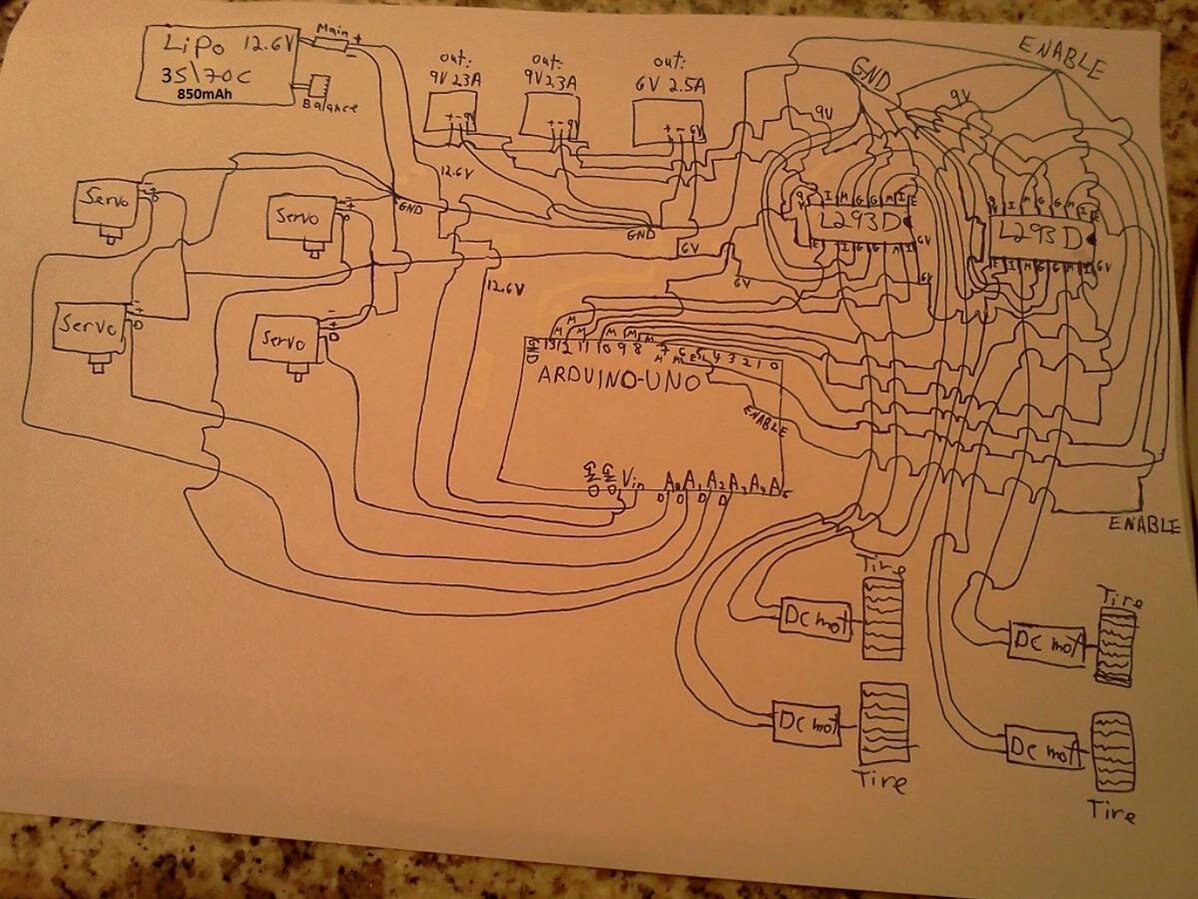

roineust over 9 years ago
Hello,
i'm not getting enough power to the driving wheels on the setup described in the following diagram.
i'v done very similar cuircuits in the past with the exact same components and the driving force from DC motors was much stronger. Can't seem to find what i'm doing wrong..
The DC motors used are these: https://www.pololu.com/product/2215
Here is the code used:

Any ideas what could be the reason for that problem?
Thanks.
    dougw over 9 years ago +2
    Ensure you use heavy enough wire and connectors that can handle the current. Check the voltage getting to the motors and trace it back to the supply, making sure it is good at each intermediate node.
    dougw over 9 years ago in reply to roineust +2
    I can offer a theory, but it is just something I have thought about - I never tested it. In a normal DC motor torque goes up as speed goes down because the current increases as the back-emf goes down.…
    jw0752 over 9 years ago in reply to roineust +2
    Hi Roi, Do you have flyback protection diodes across the motors. I have seen where the counter EMF if not eliminated can mess with the outputs of the drivers. John

    You could require up to near an Amp of current to drive each wheel. That depending upon which motor you are using. Follow Douglas Wong's advice to see if you have full voltage at the motors while power is applied. You may have to modify the program so that voltage is continuously supplied to the "test motor while the voltage is being measured.

    I'm getting 3.5V instead of 9V at the motors + and - while they are running. i'll be checking the intermediate points again soon, although i think i already did that and the only intermediate points are before and after the L293D and there i get 9V. The wires are about 1 meter long, but i think not too thin..they don't warm up, that is for sure..

    Since you are using 6V motors you should not be using 12V or 9V for the source. you say that the voltage did not change when connected directly to battery? Did the voltage measured at the motor at that time still read 3.6V I suspect that that you are measuring the voltages after being processed by the  Arduino. In which case You are measuring the average voltage which is not DC. you may have to borrow an oscilloscope to see the true results.

    Here are the results of the measurements, the problem is that in previous configurations, i'm sure i was able to get no dependency between speed and power - i was getting very nice power also at lower speed e.g. analogWrite(E,30), now i'm getting high power only when the speed is also higher and not when the speed is low. I just don't understand what is different: Same type of battery, same type of motors, same length and type of wires, same type of Arduino, same type of L293D chips, same code. This is very confusing.. it is essential for me to get good power at low speed and i'v been there already and unable to get there again.
    9V (from regulators)analogWrite(E,30);analogWrite(E,255);
    Before L293D~9.0V~9.0V
    After L293D~2.4V~7.6V
    At motors~2.4V~7.4V
    Motor Speed (S) and Power (P)
    S:med-
    P:low
    S:high
    P:high
    12V (bypassing regulators)analogWrite(E,30);analogWrite(E,255);
    Before L293D~12.3V~12.3V
    After L293D~4.2V~10.8V
    At motors~4.0V~10.2V
    S:med+
    P:low+
    S:high+
    P:high+
    Do you have an idea what am i doing wrong?
    In a stepper motor or PWM drive it is a bit different.
    DC motor torque is proportional to current in the motor.
    The current through the motor is generated by averaging a constant (peak) voltage PWM signal. The motor inductance does not allow instantaneous changes in current, so high frequency PWM just gets "filtered" to an average current. At low duty cycle this becomes a low current, and low torque.
    If you reduce the PWM frequency (but maintain the same PWM duty cycle) the individual pulses will be longer, allowing the current to build up to maximum and thus apply maximum torque during the "on" period.
    If you go too low on the frequency the motor will start to vibrate and buzz or jerk, but you may be able to find a magic frequency where the buzz is acceptable and the peak torque is increased.
    Some of the motors I have used seem to start vibrating when the frequency falls below 300 Hz and the vibration gets pronounced below 200 Hz. You could try running in this frequency range to see if it increases apparent torque.
    What PWM frequency are you running?

    I don't know what PWM frequency i'm running or what is the duty cycle..
    None of them has to do with the line in the code i'm referring to all the time? which is: analogWrite(E,30); which goes from the Arduino to the L293D enable chips legs??
  • gdstew
    gdstew over 9 years ago in reply to roineust
    According to the documentation for analogWrite() on the Uno most PWM pins are approximately 490 Hz, pins 5 and 6 are approximately 980 Hz.
