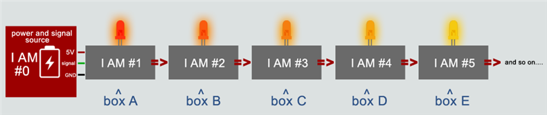

I want to have several circuits in different boxes that can connect and communicate in a basic form.
the first box has voltage source let's say a 9v battery and also an arduino board, lat's call it the "master box".
the other boxes (let's call them slave boxes) get their power from the master box and also has an led, the closer the slave boxes are to the master box, the brighter the led.
here is a simple sketch i made (excuse my lack of skill):
so far it's simple but keep in mind that these boxes can be interchangeable.
so if i replace box E with box A, box E will get a value of #1 (because it's closest to the source) and box A will get the value of #5.

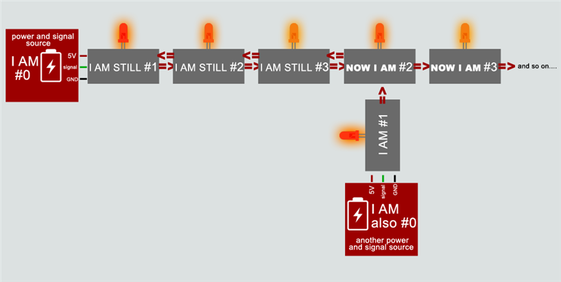

Now let's say we add another voltage source:
as you can see the slave boxes get their value from the master box and the smaller value (ie the closer to master) get's override by the higher value (the farther from another master).
so by introducing another source, box D got it's value overridden to #2, box C remains #3 because it's sits in the middle between both masters.
what i have so far:
so my idea is to put an arduino in each box and use PWM to communicate between the boxes.
so the master will output 255 and box A will take that and subtract an amount (let's say 10) and will output 245 and so on.
if another pin will show a higher value, it will override and the output will be the higher value minus 10.

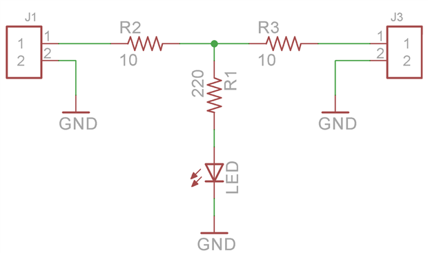

    dougw over 8 years ago
    A simple resistor network might get you close enough.....This is one node...
    You may need to adjust the resistor values depending on how many LEDs you have....
