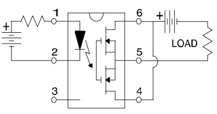

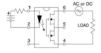

  • rachaelp
    rachaelp over 9 years ago in reply to roineust
    It's an LED in the input, you put a series resistor to limit the current. The Vf of the LED will be 1.2V so you take your output voltage from your Arduino pin, subtract Vf and then select your resistor to give the appropriate current using ohms law. Looking that the IRF datasheet it'll allow 2.5A output current with a 5mA LED current so 5V - 1.2V = 3.8V. R = V/I so 3.8 / 0.005 = 760R. Choose the nearest standard value to that and it should be fine driving it from the Arduino output pin. You might want to check the actual output voltage you are getting in case it's lower than 5V and adjust your resistor accordingly.

    dougw over 9 years ago in reply to roineust
    Nice choice Jon,
    The device is fully on with just 5 mA through the LED so it can easily be driven by an arduino with an appropriate resistor as indicated by rachaelp.
    This gets you 2.5 A ac when connected like this:
    There would be a voltage drop of 0.25V with a 2.5A load.
    5 mA input allows a 4.5 A unipolar output when both FETs are in parallel, like this:
