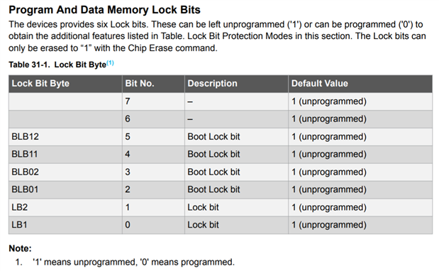

    shabaz over 9 years ago
    Hi Christopher,
    I've not used the ATmega for a long time, many years (and I too found the tools like genuine AVRisp Mk2 to be unreliable, even the Olimex clone worked better!) so I'm only guessing unfortunately: I'm wondering if it could be this, the command line has the text "lock:w:0x3f" and the first bit of debug has this:
             0xff != 0x3f
    avrdude: verification error; content mismatch
    According to the ATmega datasheet, only 6 bits in the byte are these 'lock bits', so 0x3f would sound right, if avrdude is functioning. However, the datasheet says that the unused bits in the byte are read as '1', so perhaps avrdude isn't being smart enough to ignore the unused bits, hence it thinks that 0xff is not 0x3f.
    Looks like someone had such an issue in Aug 2016: https://github.com/arduino/avrdude-build-script/issues/2
    so maybe either the avrdude executable is too old, or they may have changed it so that the command line needs to say "lock:w:0xff" instead of "lock:w:0x3f".
    It is crazy though if they changed the CLI so that now it is not backward compatible and all the people who typed 0x3f now have to type 0xff. But sometimes engineers do such irritating things! : (
