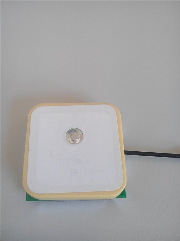

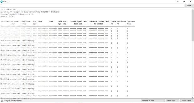

Hello everyone!
So this week i got a Neo-6M GPS shield in the mail, because I need it for a school project. However I'm a newbie when it comes to arduino programming, so I grabbed some code on the internet that said it'd function with this module.
But bad luck; I can't get this gps module to work and display my location, instead it gives me a bunch of characters on the serial monitor that I can't understand...
Could it be a problem with the program? Or maybe the antenna, or the GPS shield itself?
Could you give me some advice to test out?
Thank you!
Here's the page I grabbed the code from: Tutorial to Communicate Neo-6M GPS to Arduino : 7 Steps (with Pictures)   And some pictures of my hardware:imageimageimageimage

    Hello,
    Looking at your images I see your serial output is garbled and it shows at the bottom you have your baud rate set to 9600. If you read the tutorial it says the module has a default baud rate of 38400. I suggest the first thing you do it make sure your serial console settings are correct so as well as setting the baud rate to 38400 you may also need to look at what parity and stop bit settings are required too. First try with just changing the baud rate and if it's still garbled then look at the other settings.
    Actually I just read the article properly, the above is not right. It does look like a baud rate configuration issue somewhere but I it might not be in your connection to the Arduino for the serial monitor....

    tlucas756 over 8 years ago in reply to rachaelp
    Hello rachael, so I messed with the baud rates and found that it starts showing something at 115200 baud.
    But the gps signal doesn't seem to work; for the record in the code it mentions London so that's probably what the gps is trying to get, but doesn't receive.
    How could I change the location to my country (Portugal) without ruining the progress I've made?image

  • rachaelp
    rachaelp over 8 years ago in reply to tlucas756
    Great, glad you have made progress! Could it be you just haven't given it long enough to get a satellite lock yet? Is the GPS antenna getting a good view of the sky? If you are indoors sometimes GPS can take a while to get a lock or even not at all.
  • tlucas756
    I was wondering is the antenna was the problem. I am indoors but close to a window, I will try to point it toward the sky to see if anything happens.
  • tlucas756
    Ok, so I pointed it to the sky, still gives me the error. so I'm assuming it's something to do with the code, but I don't know what...
    I noticed the shield has some jumpers, maybe if I change them around it'll behave differently
  • rachaelp
    Those jumpers look to just be for configuring which of the digital IO pins on the Arduino are for the TX and RX of the module. Just make sure they match the config in your code.
