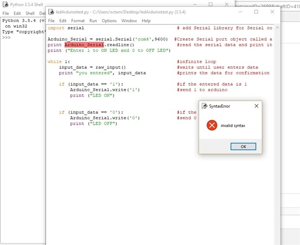

Coding Arduino in Python but got an error and have no idea why please help me
My Code:
import serial                                 # add Serial library for Serial communication
Arduino_Serial = serial.Serial('com4',9600)  #Create Serial port object called arduinoSerialData
print Arduino_Serial.readline()               #read the serial data and print it as line
print ("Enter 1 to ON LED and 0 to OFF LED")
while 1:                                      #infinite loop
    input_data = raw_input()                  #waits until user enters data
    print "you entered", input_data           #prints the data for confirmation
    if (input_data == '1'):                   #if the entered data is 1
        Arduino_Serial.write('1')             #send 1 to arduino
        print ("LED ON")
    if (input_data == '0'):                   #if the entered data is 0
        Arduino_Serial.write('0')             #send 0 to arduino
        print ("LED OFF")

    shabaz over 8 years ago
    Hi,
    This is a guess (I don't know Python very well), you probably need brackets, i.e.
    print(Arduino_Serial.readline())

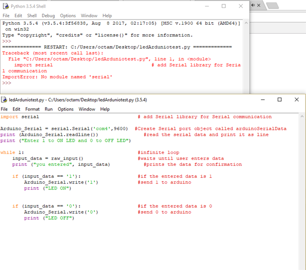

  • the_future
    the_future over 8 years ago in reply to shabaz
    project from : https://www.electronicshub.org/controlling-arduino-led-python/
    thanks now I have added brackets to my code I have a new error the thing
    is that I have properly already installed the serial library using CMD
    so what I am missing?
  • jj57
    jj57 over 8 years ago in reply to the_future
    I think the problem is in your setup command.
    You probably typed:
      python setup.py install
    but since you are using python 3.x (as compared to 2.x in the example you are following) you would need to do:
      python3 setup.py install
    as explained here:
    https://pythonhosted.org/pyserial/pyserial.html#from-source-tar-gz-or-checkout
  • the_future
    the_future over 8 years ago in reply to jj57
    getting the message -> 'python3' is not recognized as an internal or external command,
    operable program or batch file.
    but when I do -> python setup.py install the cmd does something
    tried to follow these steps : https://github.com/Langoor2/PokemonGo-Map-FAQ/wiki/%27python---pip%27-is-not-recognized-as-an-internal-or-external-comma…
  • gecoz
    gecoz over 8 years ago in reply to the_future
    Since the "python setup.py install" seems to be working, probably your Python 2.7 environment is correctly set up. On the other hand, the error you get using the "python3 ..." command is a strong indicator of an improperly set up Python 3 environment. You can find more information on configuring/running Python 3 on Windows on the official Python3 documentation.
    I hope it helps.
    Fabio
    P.S: Once you configured your Python3 environment properly, I would advise to use pip to install the Python packages (like the pyserial package needed to run your script), as it makes the management of the packages a lot easier.

  • jomoenginer
    jomoenginer over 8 years ago in reply to the_future
    I'm assuming you are running on Windows, so it would be best to check the output of 'env' to see what version of Python is set in your PATH environment variable or if you have a PYTHONPATH set.
    However, to switch between Python 2.7 and Python 3 on the command line in Windows 10, just type 'py -2.7' or 'py -3'.  If you just type these then you should drop into the Python command console which will show the version of python that is running.
    https://docs.python.org/3/using/windows.html
    From the Python command console, just type 'import serial' to see if serial has been installed for that version of Python. If you get no errors, then it is installed.
    To run this with a script, you would type 'py -2.7 my_script.py'.  This should run the script as a Python 2.7 script.
    You could add a 'env' statement at the head of the python file to see if that forces the file to run with a particular Python version.
    Ex:
    #!/usr/env python2.7
    The other option is to use Python Virtual Environment to configure a specific python version config for whatever version of Python you need to run.
    https://docs.python.org/3/tutorial/venv.html
    I hope something here helps.
