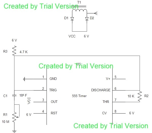

First of all I would like to say is sorry about my last post. My last post about voltage regulation was too difficult for me and that's what it really came down to. So I have decided to give up on that project and start a new one. First of all I am building a FM radio transmitter with a 555 timer. In order to build a 555 timer fm radio you need a capacitor. But I am not sure what farads of a capacitor I need. More or less I am not sure I what I know is correct. I think according to my math I need a 18000000 Farad capacitor which is really impossible to get to. I want my radio transmitter to broadcast up to 108 MHz through 88 MHz which is your basic broadcast signal. But am I right. You see here is my math, one Ampere times MHz divided by six because I am using six volts. Any questions ask me or look at my diagram. Thanks!!!

    Hi Noah,
    The calculator from Neil's link will calculate up to kHz. The reason it won't do MHz is because as John pointed out in a comment above: you can't do that with a 555 timer.
    According to the data sheet, the NE555 you are using has a maximum frequency of 100kHz.
    According to Wikipedia most of the world has FM radio in the range of 87.5 MHz to 108.0 MHz. Japan starts at 76MHz. That's starting at 76,000 kHz or 76,000,000 Hz.
    So that's about a magnitude too high for the 555 to handle.

    John and Neil, for my education - am I understanding this correctly? the spec sheet says it can go up to 100kHz (0.1MHz), FM radio here needs at least 87.5 MHz, yet there are plenty of articles and schematics out there claiming to use just a single 555 chip with some passives to make a short range transmitter.
    Noah, What exactly is your question?
    Earlier you replied to me that it was not "how do I build an FM transmitter" because you can do that most easily by using that RaspberryPi you said you have.
    Now it looks like the question is "How do I build an FM transmitter using only an NE555 chip with a few capacitors and resistors", but there are so many articles and schematics available for that, that I doubt that's the question or your Google searches would have given you all you needed.
    I'm not an RF expert, but I think what's going on in the 10 pF circuit is that you're hearing a harmonic of the frequency the 555 is really running at.  The 555 generates a square wave, which is very rich in harmonics: see Wikipedia.  The FM receiver is catching one of them, but it's so weak that you have a very short range.  It would be nice to hook up a 'scope to that 10 pF circuit and see what the square wave really looks like.

    Ah thank you, that would make sense. Plus since it doesn't specify a frequency and it doesn't send anything other than noise, I'm guessing it's not a very accurate frequency that it creates.
