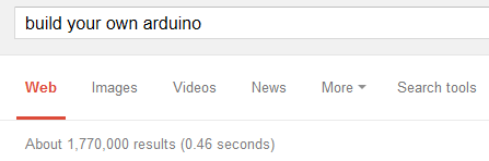

i am making a custom board using atmega328p. i am programming the chip using a arduino uno board which works fine but when i attach the microcontroller to the development board, the delay function doesn't seem to work. I think there is a problem with the oscillator. I have simply connected a crystal at xtal pins. Is this the correct way??

    What frequency is your crystal?
    Have you connected 20/22pF capacitors between the XTAL pins and gnd?

    If you search for schematics there are plenty to show you need 2 x 20pF caps and a resistor.

    You need the capacitors as well! This allows the charge up on either side of the crystal....
    Add a 16 MHz external clock between pin 9 and 10, and add two 22 pF capacitors running to ground from each of those pins.

    The Bare Bones project tend to use a resonator, although they talk about a xtal and neglect to say you need the capcitors.
    http://moderndevice.com/wp-content/uploads/resources/bbb-kit/BBB_RevE_Instructions03.pdf
    But seriously can no-one use the google search to find the million or so links for building their own Arduino.?
    This has some links that land on the wrong page, but does get you there.
    http://playground.arduino.cc/Learning/AtmegaStandalone
