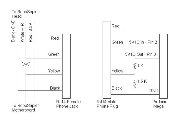

- Afterwards, Remove and disconnect all wires from the board and unscrew it. Pin connections are imbued on the PCB's under side so check that for the connections. For this experiment, we will be using the VCC, GND and  IR pins. Solder about 15 cm of wires to  each them as such.
Step 2: Connect to the PIC
- Mount the 3 connections mentioned above to your microcontroller (I used an Arduino Mega atm for this).
The IR signals, per se, are separated by spaces meaning that each bit that passes data will create a high and then a low right after. The pulses will indicate if the bit is 1 or 0.
I experimented quite a bit on coding in order to get the establishment between the two right, and this is what I came up with:

The output data seems to come out easily, so that was a good start.
Step 3: Web Code Implementation
The microcontroller will enable us to emulate the same binaries that the original remote that came with the packaging gives. Since we were able to pull them from the code used in the previous step, we are now ready for serial communication. The control board must be triggered on remote mode so as to prevent any disruptions when booting up, which afterwards it can be switched back to where you assigned the MCU.  Plug the wires to their respective assignments based on the code below. You may add an LED as an optional accessory to indicate if it works. Upload the following code:
