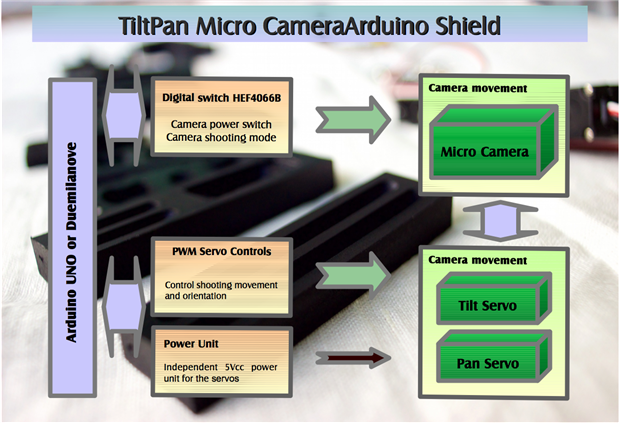

The image below shows the block diagram of the electronic design. This design has been though to be applicable also to another kind of camera, I mean a normal size DSLR camera with very few changes. Few notes about the functional blocks:
  • In the adopted micro camera model the operations are controlled manually by two switches while in the normal DSLR - especially the Canon EOS seris - the remote control buttons (e.g. flash or autofocus or shooting etc.) are cotrolled trhough a jack. In both cases I have experienced that, despite what many circuits shows, to generate the button click it is not sufficient a simple transistor. As a matter of fact, something it works but in some other cases don't. So to be sure that the automated action is exactly the same as the manual action I will use a digital switch.
  • In this case - to be used to make stop-motion sequences the movements of the camera are controlled by a couple of servos. The tilt micro servo has a max angle variation of about 160-170 DEG, sufficient for the azimut inclination while the base pan servo is a full rotation servo. Both devices works at +5V. As the servos need a discrete amount of power a separate regulated power line is used to power them.

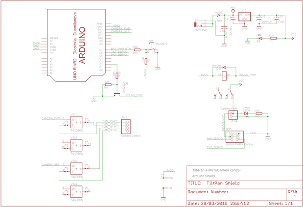

The schematics
The following image is the finished schematics of the shield board. Every single block has been tested separately, so hopefully this will work.
Thanks to lokkytron and clem57 for the advices.

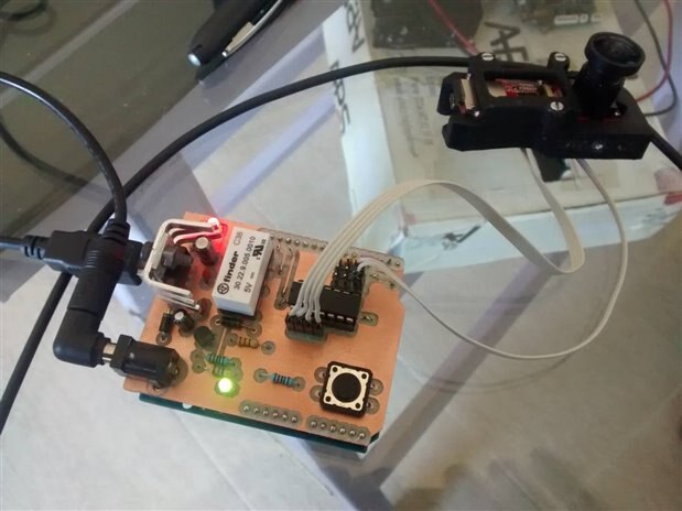

I close this document with an image. The state-of-the-art of this project has reached the prototype circuit that until the actual tests done, seems perfectly working as expected. The following is the image of the Arduino Shield prototype on an Arduino UNO R2 running a simple program to test the parts.
Referencing the image to the schematics
Just to understand the circuit parts shown in the image above:
  • The left side of the circuit is the 4.7 Vcc regulated power supply for the external devices
  • The red LED is the external power active
  • The white finder relay deliver the external regulated power source to the external devices (camera and servos)
  • The green led indicates when the external devices are powered
  • The bottom-right button is the external power on/off touch switch
  • The 16/2 pins integrated on top-right is the digital switch simulating the camera control buttons (power, shooting mode, start shooting etc.)
All is controlled by the micro controller software.

    Anyway I again have a couple of doubts. The first is related to the camera that I hope to solve with the producer: as the camera is powered by 3.3V and consumes about 300 mA maybe a good idea or at least a good try to power the device with the Arduino 3.3 V
    The second instead is about the idea to setup two relais (not solid state) to enable the power lines, so the entire engine is really under the full control of the microcontroller. What do you think ?
