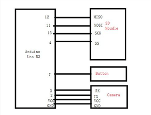

I have tried to draw up a sketch of what components I have. I don't know if I would need to connect the camera to the LCD screen, or if the information would be carried another way?

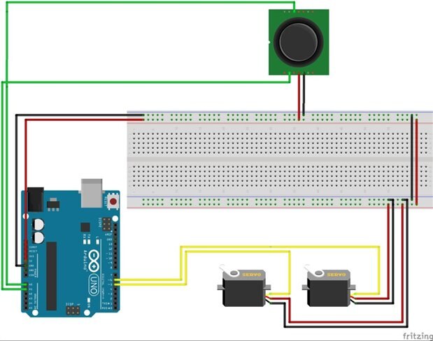

Also here is a diagram for just the servos being controlled by the joystick that I have managed to do:

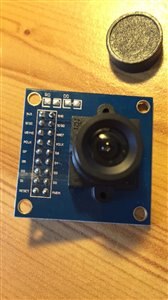

A question about connecting the camera module though:
  • In the Camera_OV7670 module DIY Guide | they show the diagram as:
However my OV7670 camera module has ports as seen in my image:
If you could give me some guidance that would be great,

Ah. The diagram expects a UART (TX<=>RX) whereas the camera is raw data. Normally you would need a controller to take raw and convert to UART. Two options:
  • Get a circuit board that handles reading raw mode. This is preferable and doable.
  • Connect the board to Uno with as many as 12 pins or more (picture not clear) and program at the bit level. If you search you may be able to find a library which would save time.
Here we introduced one OV7670 camera module just purchased online, including the communication of camera module and Arduino UNO, the using ways to take photo via camera module, and so on. This is an Arduino camera module,  adopted the Surveillance cameras digital image processing chip-OV0706, specially designed for image acquisition and processing application,  based on TTL communication interface, very convenient to connect with Arduino controller, able to read image and data via UART serial port, and then perform some image processing. This is a detailed DIY guide for the OV7670 TTL and UART camera, and you can also download the code from ElecFreaks.
camera 0706 A
Clem
Sneaky #$%#% showing module with UART and selling one without. It is important to compare the pictures and see the details before hitting the buy button.
Clem
Clem, I have looked at the diagram. What I see is that there is a scheme connecting two different dvices: The pins 122, 12 etc are related to the SPI (essentially the same pins used to program the AVR328p without the bootloader. This has nothing to do with the camera, as for as I know. It is used - I have already used in past - to connect the memory card.
Instead the camera should be simply powered and connected to the pins 0 & 1, alias the serial connection: what is this device is a serial camera so it works via the UART on the board. Don't you agree ?

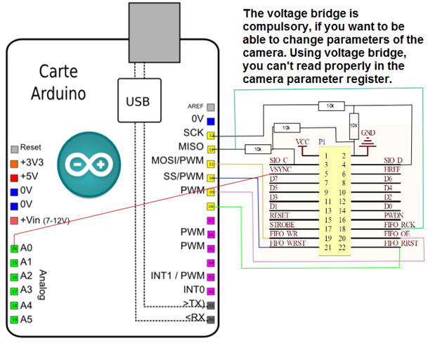

I am trying to follow the blog you sent me to:OV7670 + fifo | A french student website
Can you help me understand this image:
What is the voltage bridge? Is it a physical thing?
Also he's using a OV7670 camera with FIFO, however mine doesn't have this I believe. Is there a way around this?
Thanks, Nate.

Hello Nate,
sorry for this missing but I was trying to complete a couple of other things ... I took a look to the circuit in the image. To be honest I am always more convinced that the fact that the reference was for a different micro than 328p just because it is what the guy had. Consider the following:
  1. Better solutions are always simple including the possibility to use what is already in your hands. You have an arduino Uno or a board based on the 328p, right ? So iin your case the first thing I will try is to use it.
  2. follow the logic: 1284 and 328p a similar, same family and works at the same speed (20 MHz); there is not an incredible usage of the board pins to really justify the usage of a bigger (not so more powerful) processor, at least to manage the camera (but at the moment I think that it is possible to manage all the components you wan to put together with a normal 328p)
  3. The camera in the schema - you have the same - is connected through the SPI pins to the microcontroller. And it is what you can do with Arduino.
  4. If I am not wrong the voltage bridge (the word "bridge" makes confusion but this is not a bridge component, I think) is the set of 4 resistors that in theory will align the power shared to the camera from Arduino. Maybe that creates problems, and this may depend (very probable I think) by the not perfectly calculated resistors values, the fact that probably it is using a breadboard that is not properly a circuit and has its own limits and many other parameters). For now, don't matter, focus one problem at a time and try this connection. Nothing explode, the worst case is that it does not work at all. But most of the progresses are based on deductions from errors and issues.
I suggest you to try this schema applied to the arduino pins and see what's happen.
Hi, you say that the camera in the schema is connected through the SPI pins to the micro controller, however his pins aren't the same as mine, so I am confused by that.
Here are my pins:
I can not understand what pins are needed, Thanks for your help.
Nate
Hi Nate,
Your camera (the one in the photo) has no buffer, and requires all pins connected as you suspect I think. Basically a couple of the pins are used to program the camera (over a serial interface) to select resolution etc., and the remainder pins form a parallel bus that send the raw video data output. Your code needs to sample the data on some clock edge (i.e. pins like PCLK, and the SYNC pins). This happens are a fairly high speed so initially you'll want to select a low-res image (e.g. QCIF, if the camera supports it). Also a fair amount of storage is needed (i.e. x resolution times y resolution bytes per frame for an 8-bit (256 color) image).
For these reasons I'd still suggest a composite camera and composite TFT if you don't need to store or manipulate the image. If you do need to store or manipulate the image, an RPI and associated camera would be pretty good.
