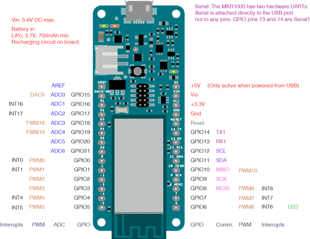

The Arduino MKR 1300 uses the same pin mapping as the MRK 1000:
Power Pins:

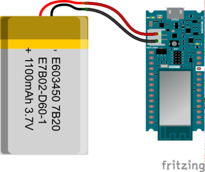

  • Li-Po (3.7V) - You can power the board by connecting a Lithium polymer battery (shown to the right) with a nominal voltage of 3.7.
  • Vin - The board can be powered by a regulated 5V supply with a maximum voltage of 6V for this Pin.
  • 5V - When the board is powered by USB, you can use this pin get +5V to power other circuit
  • Vcc - This pin uses the on board regulator IC to output a regulated 3.3V
  • GND - Ground Pins
Reset Pin - Bring this line LOW to reset the microcontroller. Typically used to add a reset button to shields which block the one on the board.
Analog Pins (Pins A0-A06) - The 7 analog pins are used to emasure analog voltage in the range 0- 3.3V with a resolution of 10 bit.
DAC0 Pin - The DAC pin is just above the Analog Pins and is used provide an analog voltage based in the digital input with a resolution of 10bit.
Digital I/O Pins (Pins 0-14) - Below the analog pins on the left and just below the reset are digital pins that can be used as either input or output pins.  Low is at 0V and high is at 3.3V.
Serial Rx, Tx Pins (Pins 13, 14) - Pins 13 and 14 are used to Receive (Rx) and Transmit (Tx) TTL serial data. These pins are connected to the corresponding pins of the FTDI USB-to-TTL serial chip.
External Interrupts (Pins 0,1, 4, 5,6, 7, 8, A1, A4) - These pins can be used to trigger an interrupt on a low value, a rising or falling edge, or a change in value. See attachInterrupt()function for details.
PWM Pins (Pins 0, 1, 2, 3, 4, 5, 6, 7, 8, 10, A3, A4) - These pins provide 8-bit PWM output with the analogWrite () function.
SPI (Pin 8 - MOSI, Pin 9 - SCK, Pin 10 - MISO) -  These pins support SPI Communication
LED - There is a built-in LED connected to digital pin 13. When the pin is HIGH value, the LED is on, when the pin is LOW, it's off.
I2C Pins (Pin 11 is SDA and Pin 12 is SCL) -  Pin 11 (SDA) and Pin 12(SCL)  support I2C (TWI) communication using the Wire library (documentation on the Wiring website).
AREF Pin - Reference voltage for the analog inputs. Used with analogReference().

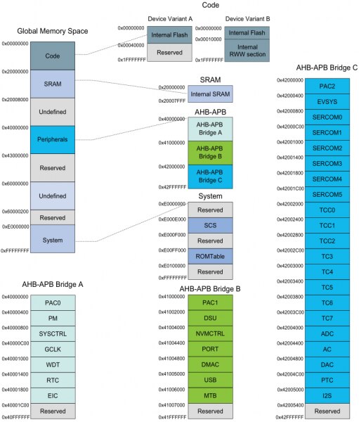

Memory Map:
