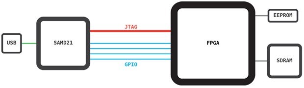

The Arduino Vidor 4000 stands out from other boards in the Arduino family due to its inclusion of FPGA.  This features should allow audio / video processing for an MKR board that was until now not possible.

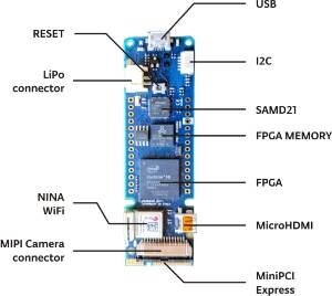

The Arduino VIDOR board consists of the following components:image
  • an ATSAMD21G18A microcontroller with 256k of Flash and 32k of RAM.
  • a 10CL016 Cyclone FPGA with 15408 logical elements
  • 504kbits of RAM and 56 multiplier 18 × 18
  • 16 Mbit SPI FLASH
  • 64 Mbits SDRAM (4M x 16 bits) a NINA W102 Wifi / BLE module integrating a ESP32 dual core microcontroller
  • ATECC508A cryptographic chip improves processing speed for secure connections.
  • MiniPCIe connectors, USB, battery, I2C, MKR, MIPI for a camera, HDMI for video output.
The combination of a SAMD21 microcontroller clocked at 48Mhz, the completely reprogrammable Wifi module, and the FPGA that supports a large number of standard I/O, the board is versatile and should satisfy a large number of uses.
The goal of the ARCHUINO system is to place the FPGA at the center of the system since it has access to almost all resources. The user is free to manage the resources in the FPGA itself or to reroute them to the SAMD21 processor or even the ESP32 of the Wifi module. If the microcontroller and the Wifi module have their own nonvolatile memory for executing a program, the initial configuration of the FPGA is loaded with each power-up since the beginning of the FLASH memory.

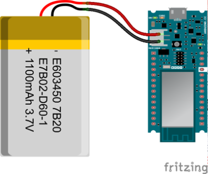

Power Pins:
  • Li-Po (3.7V) - You can power the board by connecting a Lithium polymer battery (shown to the right) with a nominal voltage of 3.7.
  • Vin - The board can be powered by a regulated 5V supply with a maximum voltage of 6V for this Pin.
  • 5V - When the board is powered by USB, you can use this pin get +5V to power other circuit
  • Vcc - This pin uses the on board regulator IC to output a regulated 3.3V
  • GND - Ground Pins

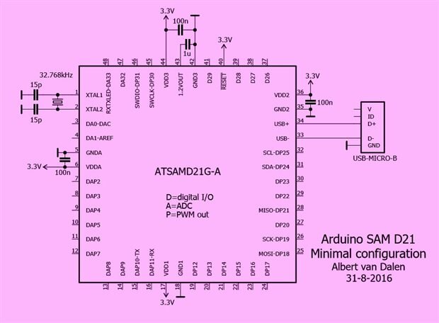

The low power, high performance ARM Cortex-MO+ is ideal for a wide range of home automation, consumer, metering, and industrial applications. Its the same SAMD21 as the MKR 1000, MKR Zero, and Arduino/Genuino Zero boards. A unique feature of the SAMD21 chip is SERCOM, a set of six configurable serial interfaces.  These can be turned into either a UART, I2C master, I2C slave, SPI master, and SPI slave. Additionally it features a 32-bit Real-Time Clock and calendar, 20 PWM channels, one 14-channel 12-bit ADC, on 10-bit DAC.
ATSAMD21G18A Overview
ArchitectureARM Cortex-MO+
Voltage Range1.62-3.63V
Bus Size32-Bit
Max CPU Speed48MHz
Internal Oscillator21khz, 23Khz ULP, 8Mhz
Program Memory Size256KB
SRAM32KB
EEPROM32KB (emulated from Flash)
GPIO38
ADC Channels14
ADC Resolution12-bit
Digital-to-Analog Converter (DAC)Yes
USB ControllerYes
Direct Memory Access (DMA)12 Channel
Peripheral Touch ControllerYes
Inter-IC Sound 12SYes
32 bits, 48 Mhz
The 32 bit architecture allows you to process your instructions faster at double the speed of an 8-bit AVR. While the AVR must process data in 8-bit, the 32-bit architecture allows the SAMD21G to process data in one large chunk.

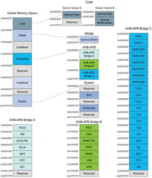

Memory Map:

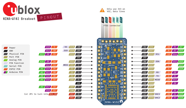

ESP32 Module by u-blox
The MKR WiFi 1010 adds an ESP32 module by u-blox which is a notable improvement from the MKR1000 Wifi. The NINA-W102 Module provides low power 2.4 Ghz 802.11 b/g/n WiFi, dual-mode bluetooth v. 4.2, and RF communication through an internal PIFA antenna.  This multiradio MCU integrates a powerful MCU with and a radio for wireless communication. Its open CPU architecture supports advanced applications on a 32-bit mcu. Radio is supported for 802.11 b/g/n WiFi in the 2.4 Ghz band, Bluetooth BR/EDR, and Bluetooth low energy.  The ESP32-W10 module has applications for automotive, smart cities, autonomous vehicles, medical technology, home and building automation.
Block Diagram:
WiFiBluetooth BR/EDRBluetooth Low Energy
IEE 802.11b/g/n
Bluetooth v4.2+ EDR
Max. number of slaves: 7
Bluetooth 4.2 BLE dual-mode
Band support
2.4 GHz, channel 1-13*
Band support
2.3 GHz, 79 channels
Band support
2.4 GHz, 40 channels
Maximum conducted output power
16 dBm
5 dBm
5 dBm
Maximum radiated output power
19 EIRP**
8 dBm EIRP**
8 dBm EIRP**
Conducted Sensitivity
-96 dBm
-90 dBm
Conductivity
-90 dBM
Data Rates:
IEEE 802.11b:
  1/2/5.5/11 Mbit/s
IEEE 802.11g:
  6/9/12/18/24/36/48/54 Mbit/s
IEEE 802.11n:
  MSC 0-7, HT20 (6.5-72 Mbit/s)
Data Rates:
1/2/3 Mbit/s
Data Rates
  1 Mbit/s
* Depending on location (country, region) channels 12-13 must be disabled and support the country determination algorithm for supporting
**RF antenna including maximum antenna gain (3 dBi)
