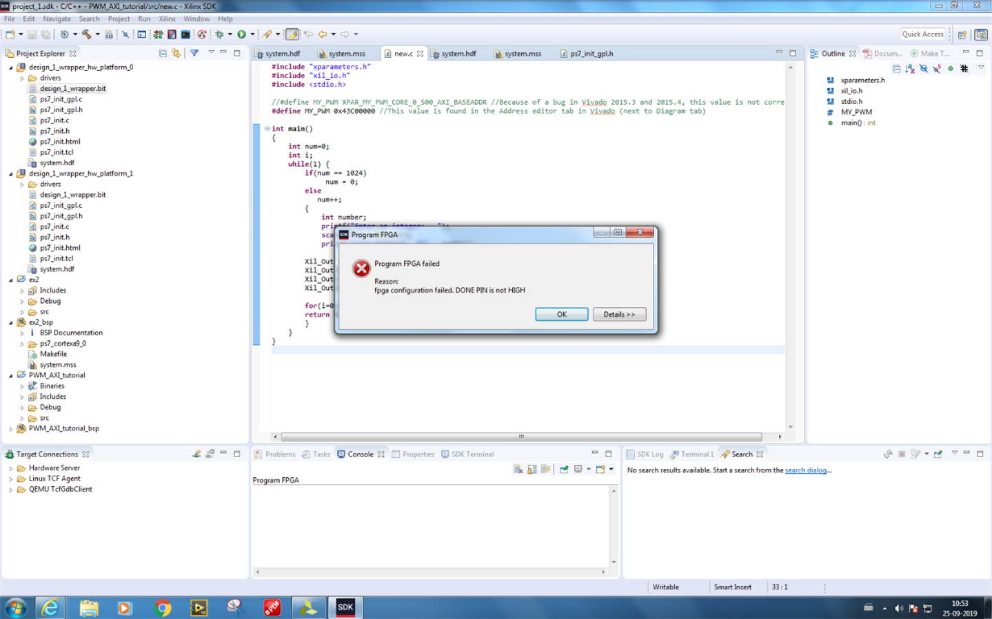

Hello,
I am designing with zedboard OEM Zynq-7000 SoC xc7Z020. Whenever i configure ZEDBOAED (PL part ) with my PC  at last  after 88% it shows error with a messege "your done pin is not high - configuration failed ".
can anyone tell me what is the problem ?
Thanks in advance.

    Which instructions are you following? Did your host detect the JTAG port?

    It is a hardware problem. The boards had a user guide that did not mention anything about some dip-switches present on the board. With wrong DIP-switch settings spi write to flash was possible but FPGA booting from flash not.
    For a complete follow-up see https://forums.xilinx.com/t5/Design-Tools-Others/DONE-pin-did-not-go-HIGH/td-p/155914

  • upadhyay_h
    0 upadhyay_h over 6 years ago in reply to bhfletcher
    Hii, sir
    yes my host detect JTAG Port.
  • upadhyay_h
    0 upadhyay_h over 6 years ago in reply to clem57
    Hi, sir
    Thanks for replaying.
    No sir  still I have a same problem.
  • jafoste4
    0 jafoste4 over 6 years ago in reply to upadhyay_h
    Just to confirm, your in jtag boot mode correct?
