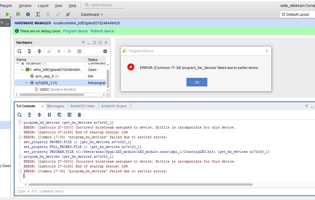

I am new in this forum. I am using a ZedBoard Zynq-7000 Development Board and familiar with Verilog modules/test bench as beginner. I am using Vivado 2018.2
I've created a top module with an output 8-bit bus (OUTPUT) and multiple inputs. My inputs are CLK (from main clock of the board), RESET (push button), ENA (ON/OFF switch), stpGo (stop and go push button).
Inside my top module I've three modules instantiated and connected to each other. I created a constraint file to connect all the ports to the necessary switches or buttons on my ZedBoard Zynq-7000.
Here is my constraint file:

set_property CLOCK_DEDICATED_ROUTE FALSE [get_nets stpGo_IBUF];
My constraint file is looking at my top-module ports only. I thought my other modules are internally connected and don't have to create a constraint file for each of them.
The error I got:
Please help me to understand and solve the issue.

    From the sparse information you provided, looks like you might have chosen the wrong part.  Make sure you are using the Zynq 7020.  Better to use a BDF, which would set everything up for you.  I'm not sure if Digilent has a BDF or not.  You'll have to check their support site.

    I did check the right part number and it matches my board. I am using xc7z020clg484-1 or ****-2 getting the same result.
    I restarted the Vivado and ran synthesize and implementation in order to generate Bitstream. Before all these steps I used this command to set Bitstream version check to "False" in my Tcl consul. After Bitstream generation was completed successfully (as system reported) I went to program my device but no Bitstream file was showing in dialog box to open. I browsed and selected a file in my impl_1 folder called CountingLED.bit. I had the same error messages after I ran "Program".
    This part number was used in another simpler project contained only one module and constraint file, it was working fine with no error generating Bitstream or programming my device. As soon as I modified my program to have a top-module with three sub modules in it the errors came up.
    Please refer to the screenshots and let me know if I am not clear enough.
