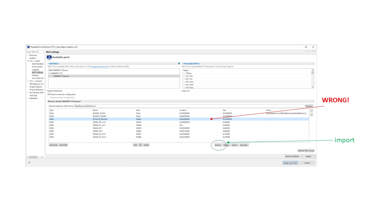

    Why did it crash?
    The original project has crashed immediately in ResetHandler, when the INTs were enabled.
    The reason was:
    During the initialization of memory sectors, esp. .bss section and fill with zeros - there was one write to a non-existing memory (0x83000000).
    Right after INT enable, inside ResetHandler() - the BusFault_Handler() was triggered. It was pending due to wrong .bss initialization and kicked in
    immediately after INT enable.
    Main reason and fix:
    Check carefully which memories are used, in the "MCU Setting". It is not enough just to modify Flash and SDRAM size, just: also check carefully if any other memory region
    is used and invalid!
    When you setup an SDK project, this "MCU Setting" is taken from SDK examples and might be still wrong!
    wrong MCU Settings
    You can use "Import" (and "Export"):
    Export from a working project, e.g. "out-of-box" demo and import
    (or import my XML file here, see in next post).
    It works for me, with 100M connector.
    Just modify the IP address used for your network.
