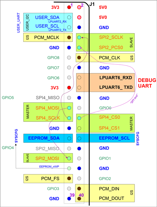

I found a second SPI on J1 header.
So, I have now implemented the "DualSPIder".
What is DualSPIder?
It is used to compensate "Round Trip Delays":
A SPI Master will send (SCLK, MOSI, CS) but the MISO signal from far end (DUT, "Device Under Test") is delayed (e.g. due to ribbon cable or additional line drivers, or using LVDS...).
So, the SCLK is "mirrored back" at the far end (affected by the same delay due to cable length and drivers) and SCLK', MISO are going into a SPI Slave (still as "synchronous").
So, it compensates the "round trip delay", or the additional delays due to line driver, LVDS interfaces...
DualSPIder approach
Figure 1: DualSPIder approach
One SPI Master and one SPI Slave: the slave receives the "mirrored" SCLK signal so that MISO and SCL are still in sync on MCU receiver (SPI is synchronous!),
never mind how long the cable is; if additional drivers are there or if we use LVDS logic (and converters on both end) - the delay is compensated by this approach.
Changed J1 pin usage
In order to gain the second SPI (LPSPI2) I had to free the Debug UART as LPUART1.
Debug UART is now LPUART6 (see the other pins on J1 and connect to it with your MCU-LINK!).
Testing SPI
if you want to test the SPI via Loopback - to see on Rx what was sent on Tx - you had to use now three wires:
J1, pin 21 - to J1, pin 31
J1, pin 23 - to J1, pin 8
J1, pin 24 - to J1, pin 10
All what you send should also be received (and reported on USB VCP UART).
J1 pin usage
Figure 2: "my" J1 pin usage for DualSPIder and for future use
