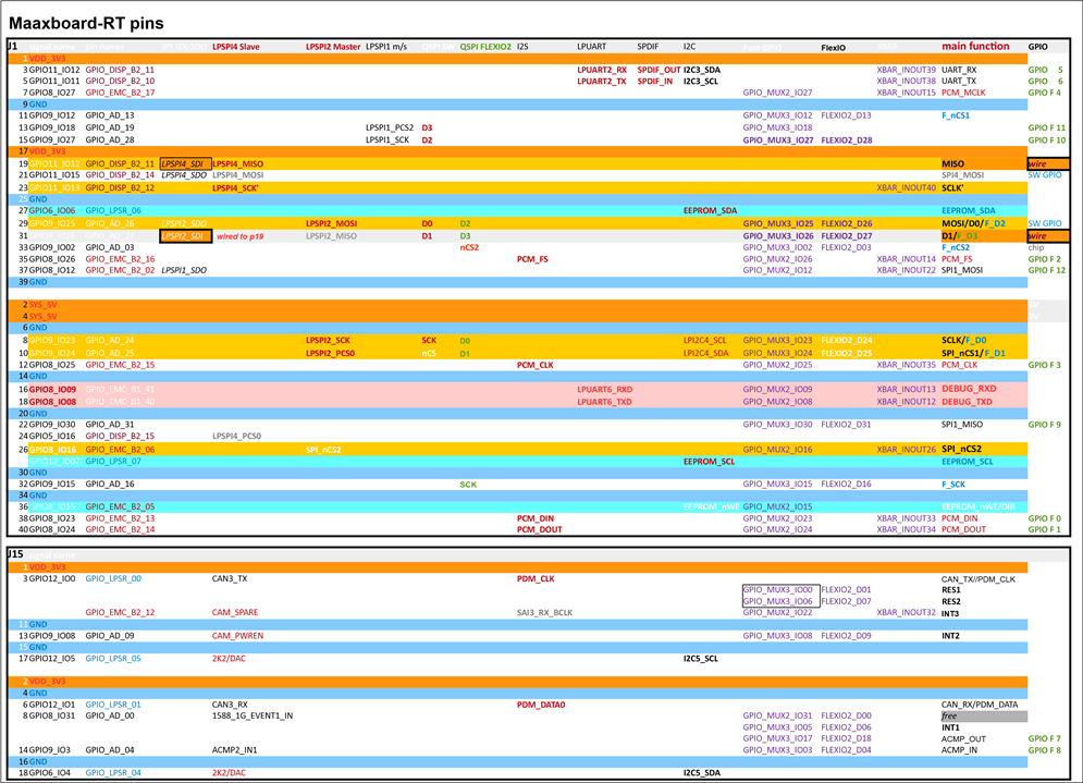

Attention: the J15 (the "other" header) pinout description in AVNET Guidelines is WRONG!
Flip pin 15 and 17:
pin 15 is GND
pin 17 is I2C5_SCL
These pins (J15, p17 = SCL and J15, pin 18 = SDA) have a 2K2 pull-up on board
and they are shared with the onboard I2S DAC (for audio out):
check which I2C Slave Address is occupied (used, by the onboard DAC) when connecting
other I2C slaves on I2C5.
J15 pinout
Figure 1: here correct MaaxBoard-RT J15 pinout

    Here is my pinmux table I want to use... Figure 1: pinmux table for my use - all pins verified to be working

    Thanks for bringing this to our attention!
    The J15 pinout that is tabled in the Hardware User Guide is being corrected to match how this custom header was implemented on the board. (An updated version of this document will be released shortly...)
    MaaxBoard-RT pinmux
