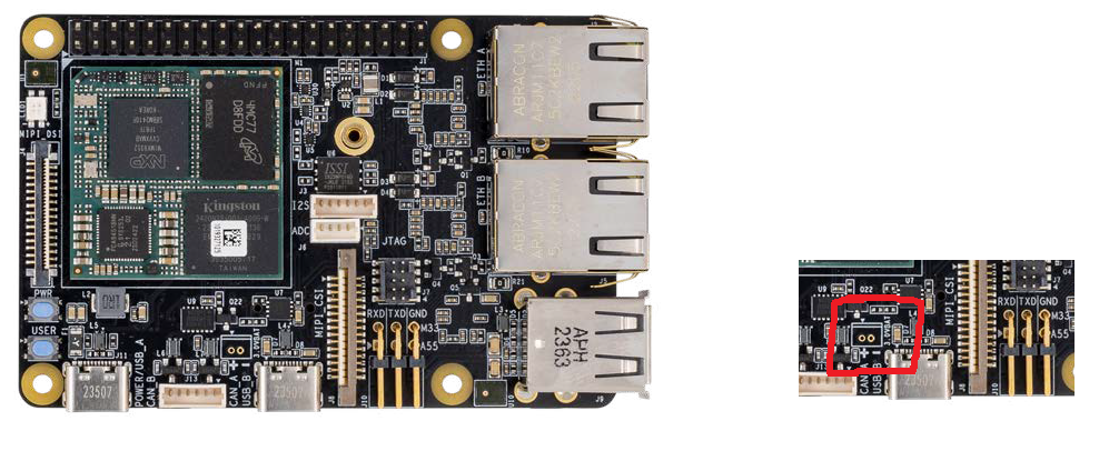

    We notice that "MaaXBoard+OSM93+User+Guide+v1.0.pdf" has this:
    While "FY25_1574_Tria_MaaXBoard_OSM93_Product_Brief-3_vp.pdf" has the below. Note the difference in the highlighted detail in the red box!
    It seems like the board layout has changed/evolved at some stage? Perhaps that changed detail (+ / -)  relates to J15?
    Does anyone have clarity on revisions of the OSM93?
    If we were to buy one of these -- would we get the layout on the top ; or the layout on the bottom?

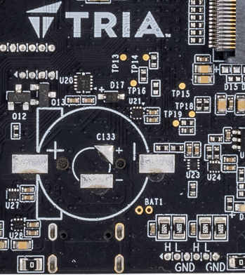

    The production version MaaXBoard OSM93 has the black soldermask as shown in the 2nd photo that you posted.
    Regarding RTC_PWR :

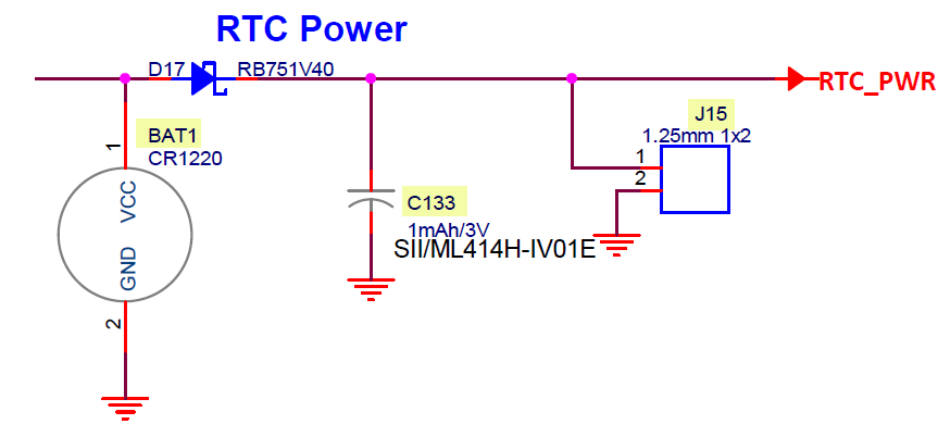

    The production version PCB, provides footprints for three different RTC battery-backup options:
    1) BAT1: CR1220 button battery-holder (not fitted)
    2) C133 : ML414H rechargeable battery footprint (not fitted)
    3) J15   : 1.25mm pitch, 2-pin header (not fitted)
    These three options can be seen on the marked-up photo of the back of the board shown below
    (BAT1 silkscreen text is misleading, as it is positioned next to the two holes of J15, but battery polarity of all of these footprints is clearly marked)
    J15 is not labled on the silkscreen, but is indeed the 2-pin header footprint that you queried:
    Regards
    -Peter
