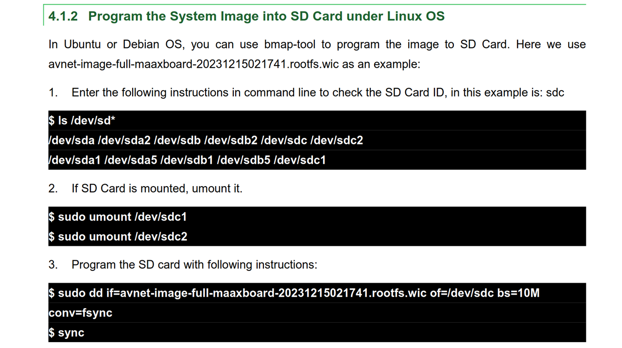

Hi Everyone!
I recently received my Maaxboard and I would like to flash a full image Yocto on microSD card. I am new to the board and Yocto. By following the user manual for Yocto Lite, (https://www.avnet.com/wcm/connect/121336f0-a62f-487c-aad9-48a72ea1f7fd/MaaXBoard-Linux-Yocto-Lite-UserManual-V1.1-EN.pdf?MOD=AJPERES&CACHEID=ROOTWORKSPACE.Z18_NA5A1I41L0ICD0ABNDMDDG0000-121336f0-a62f-487c-aad9-48a72ea1f7fd-nZCsDkH?MOD=AJPERES&CACHEID=ROOTWORKSPACE.Z18_NA5A1I41L0ICD0ABNDMDDG0000-121336f0-a62f-487c-aad9-48a72ea1f7fd-nZCsDkH),
I am able to install Yocto Lite version on my Maaxboard. However, my project involves in adding an ADC on board, It seems like Yocto Full Image mentioned on the Yocto user manual ( https://www.avnet.com/wcm/connect/3cb1a777-3aa8-4394-9ba8-135d9ffa1470/MaaXBoard-Linux-Yocto-UserManual-V2.1.pdf?MOD=AJPERES&CACHEID=ROOTWORKSPACE.Z18_NA5A1I41L0ICD0ABNDMDDG0000-3cb1a777-3aa8-4394-9ba8-135d9ffa1470-oPqIZjK?MOD=AJPERES&CACHEID=ROOTWORKSPACE.Z18_NA5A1I41L0ICD0ABNDMDDG0000-3cb1a777-3aa8-4394-9ba8-135d9ffa1470-oPqIZjK),
may fit my need better, e.g. overlays support and package management like I2c tools, etc. So I need to flash my microSD card with a Yocto Full version. I could not find it so far.
Can anyone please send me the source about this Yocto Full Image "avnet-image-full-maaxboard-20231215021741.rootfs.wic " which is mentioned on the Yocto user manual on section 4.1.2 ? Thankyimage
Thank you so much!
