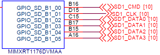

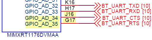

Hello everyone,
The Hardware User Guide states that the BT interface of 1ZM is connected to LPUART10. LPUART10 uses pads AD_34 and AD_35 for CTS/RTS which are actually occupied by WiFi SDIO. So, this looks like an error in the document.
Which pads and UART interface are actually used for the BT? Is there any demo application for the board that supports BT?
Regards, Dmitry
  • peterfenn
    0 peterfenn 9 months ago
    Dmitry
    Processor pinout confirmation for Bluetooth UART interface:
    Schematic details of the LPUART10 (Bluetooth) interface to the RT1170 SOC are shown below, as well as that of the SDIO1 (Wi-Fi) interface:
