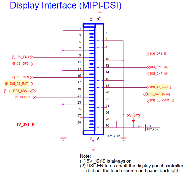

Hello,
Could please someone from Avnet confirm that the DSI connector pinout on the MaaxBoard-RT is the same as published here https://community.element14.com/products/devtools/avnetboardscommunity/avnetboard-forums/f/maaxboard-hardware-design/40085/differences-of-raspberry-and-maaxboard-mipi-dsi-port?ReplySortBy=CreatedDate&ReplySortOrder=Ascending ?
We are working on a Linux port to MaaxBoard-RT, currently trying to bring up RPI 7" DSI LCD.
Regards,
Sergei
  • peterfenn
    0 peterfenn 8 months ago
    MaaXBoard RT has a 2-lane MIPI DSI interface as shown below.
    (The pinout is compatible with the 4-lane MIPI DSI pinout on the higher-end Linux-based MaaXBoard SBCs and the 7" panel from Tria (available via Newark, Farnell, etc)
    https://www.tria-technologies.com/product/maaxboard-rt/
    https://www.tria-technologies.com/product/mipi-dsi-7-inch-capacitive-touch-display/
    Part#:  AES-ACC-MAAX-DISP2
    https://www.newark.com/search?st=%22AES-ACC-MAAX-DISP2%22
    PS: Besides the high-speed MIP interface,the 30-pin connector pinout includes touchscreen support as highlighted below
